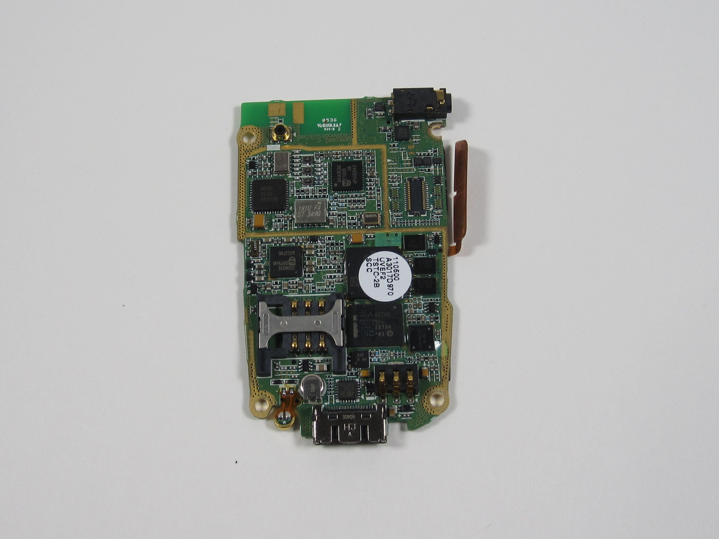

Image #1
Add Note Edit Step 6 — Motherboard  ¶
  • Remove the ribbon wires connecting to the screen using the pry tool.
Image #1
Add Note Edit Step 7  ¶
  • 2 tabs hold the motherboard in place.
  • Release the labeled tabs with the pry tool from the location shown.
Image #1
Add Note Edit Step 8  ¶
  • Separate the motherboard from the phone.
