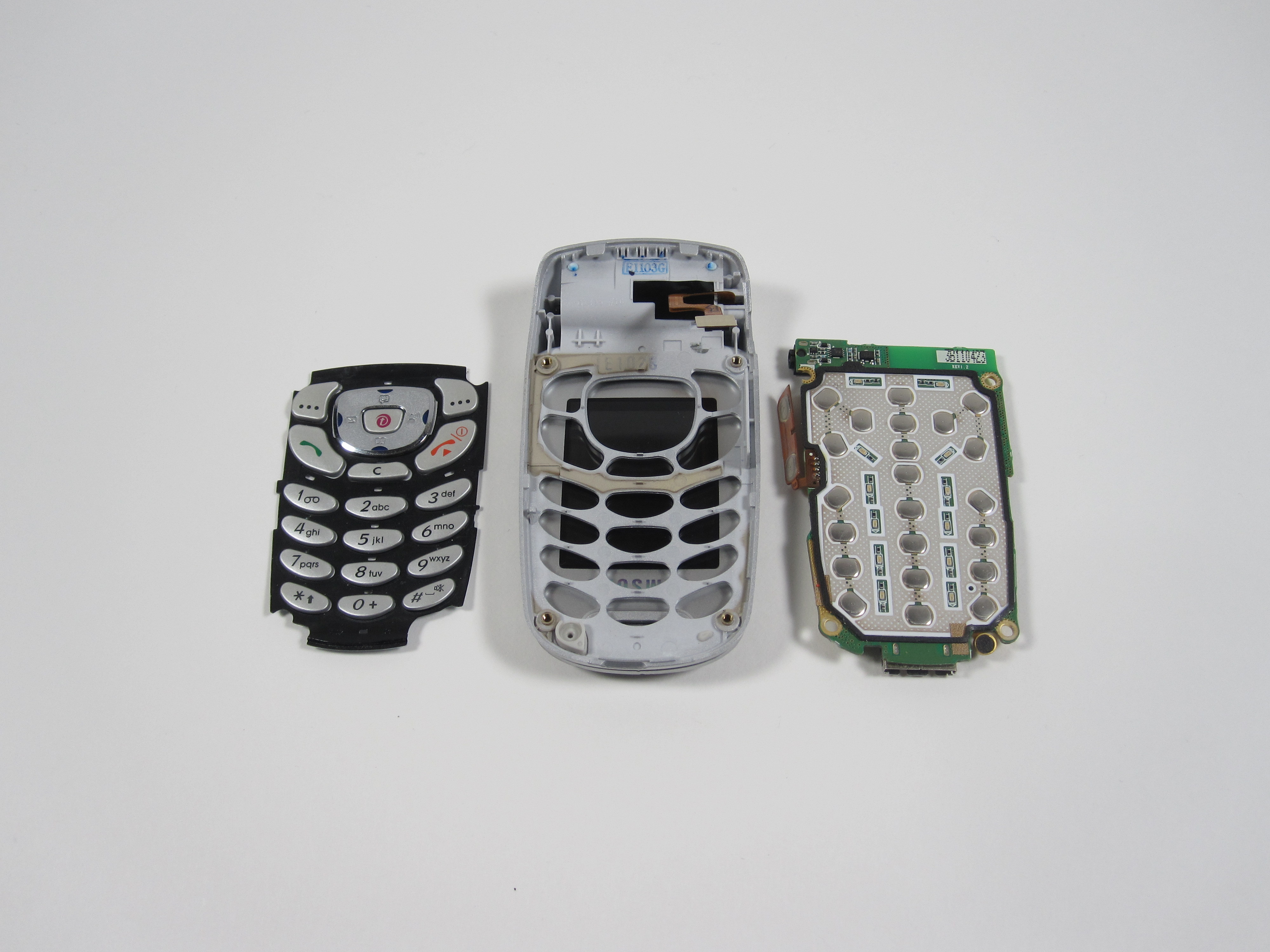

To replace the keypad if numbers are worn off.
  • Author: Matthew Hove
  • Time required: 20 minutes
  • Difficulty: Moderate
Sections
Image #1
Add Note Edit Step 1 — Motherboard  ¶
  • Remove the ribbon wires connecting to the screen using the pry tool.
Image #1
Add Note Edit Step 2  ¶
  • 2 tabs hold the motherboard in place.
  • Release the labeled tabs with the pry tool from the location shown.
Image #1
Add Note Edit Step 3  ¶
  • Separate the motherboard from the phone.
Image #1
Add Note Edit Step 4 — Keypad  ¶
  • Key pad is readily removable.
  • A view of the mother board with keys, keypad, and the phone's body.
