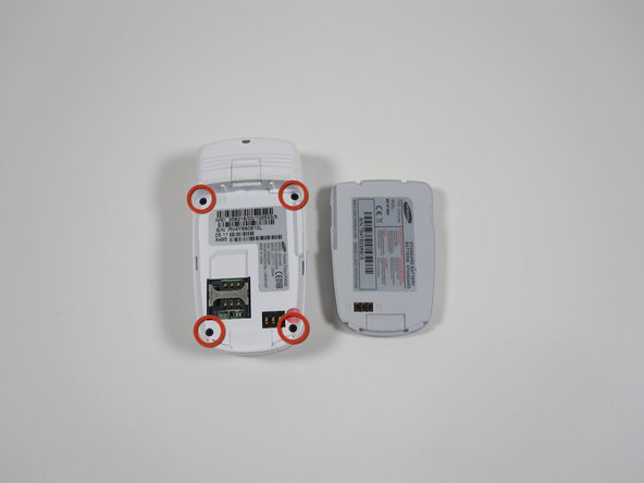

Add Note Edit Step 1 — Backplate  ¶
  • Remove the 4 (4.7mm) philips head screws.

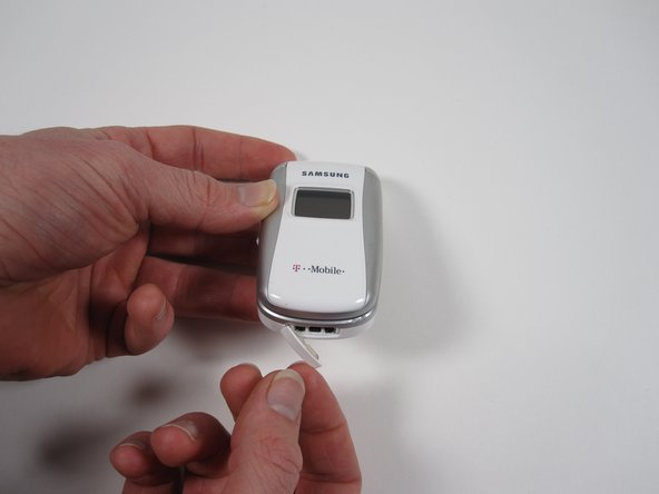

Add Note Edit Step 2  ¶
  • Unplug the rubber charger outlet cover.

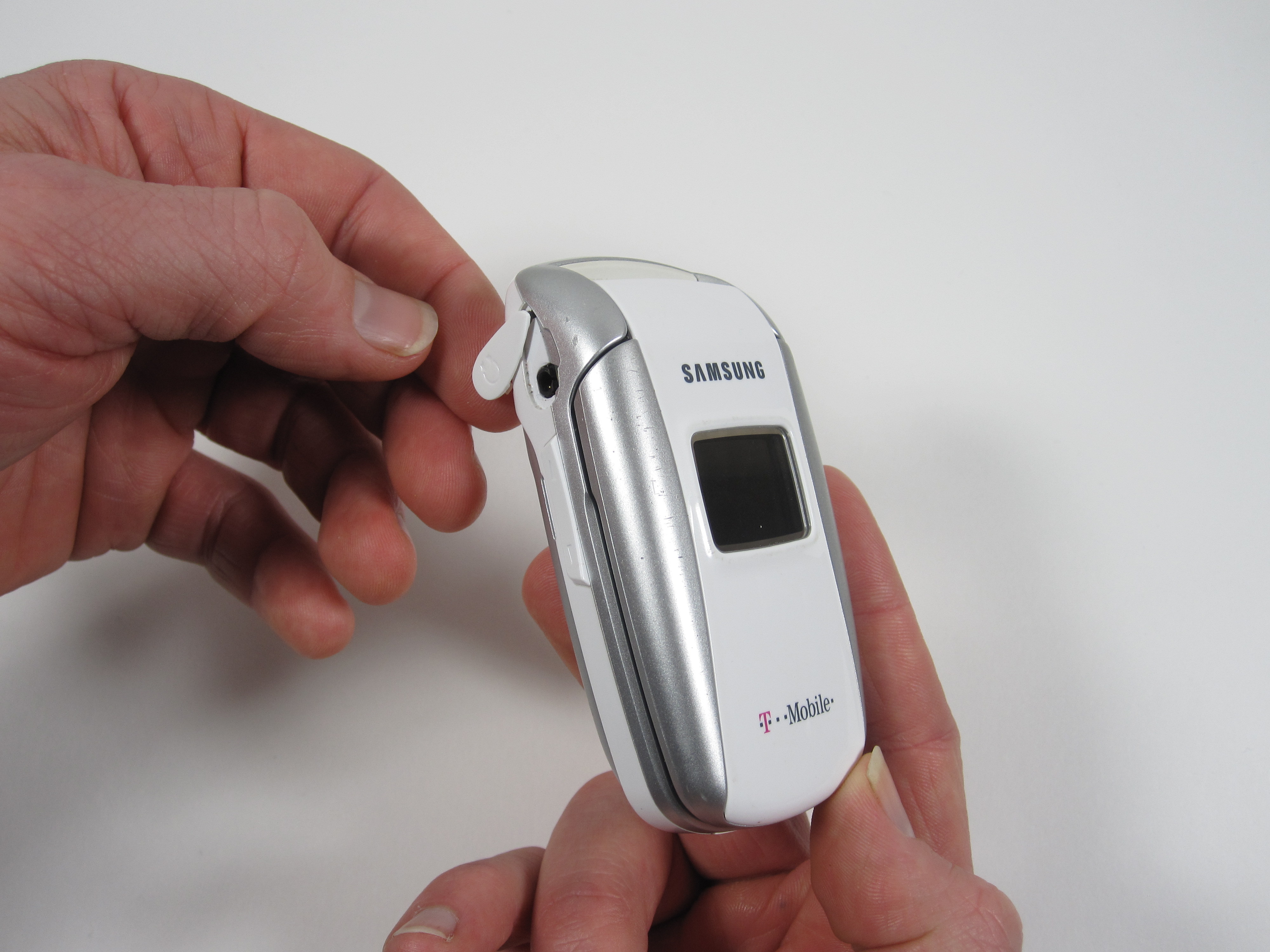

Add Note Edit Step 3  ¶
  • Unplug the rubber headset jack cover.

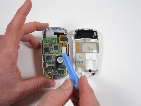

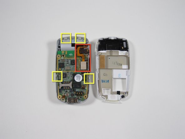

Add Note Edit Step 4  ¶
  • Begin by inserting the pry tool near the charger jack.
  • There are 4 tabs to release.
    • Start at the bottom and slide the tool up, lifting the silver front of the phone away from the white backing.
  • Loosen the 2 side tabs before moving on to the top two.
  • See the second photo to see location of the tabs.
  • Be careful of the ribbon wires shown in second photo.
Image #1 Image #2
Add Note Edit Step 5  ¶
  • Once the two side tabs are free; gently pry the white backing down to release the top two tabs.
  • Hold the phone with the left hand as shown
  • Wiggle the white backplate from side to side while pulling down with the right hand.

Add Note Edit Step 7  ¶
  • 2 tabs hold the motherboard in place.
  • Release the labeled tabs with the pry tool from the location shown.
