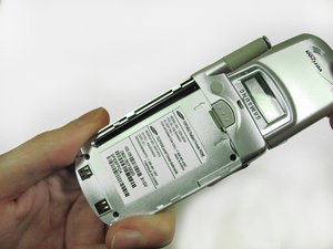

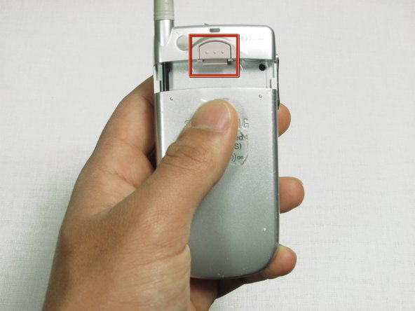

  • Remove the battery by pressing the button at the top of the case.
Image #1 Image #2 Image #3
