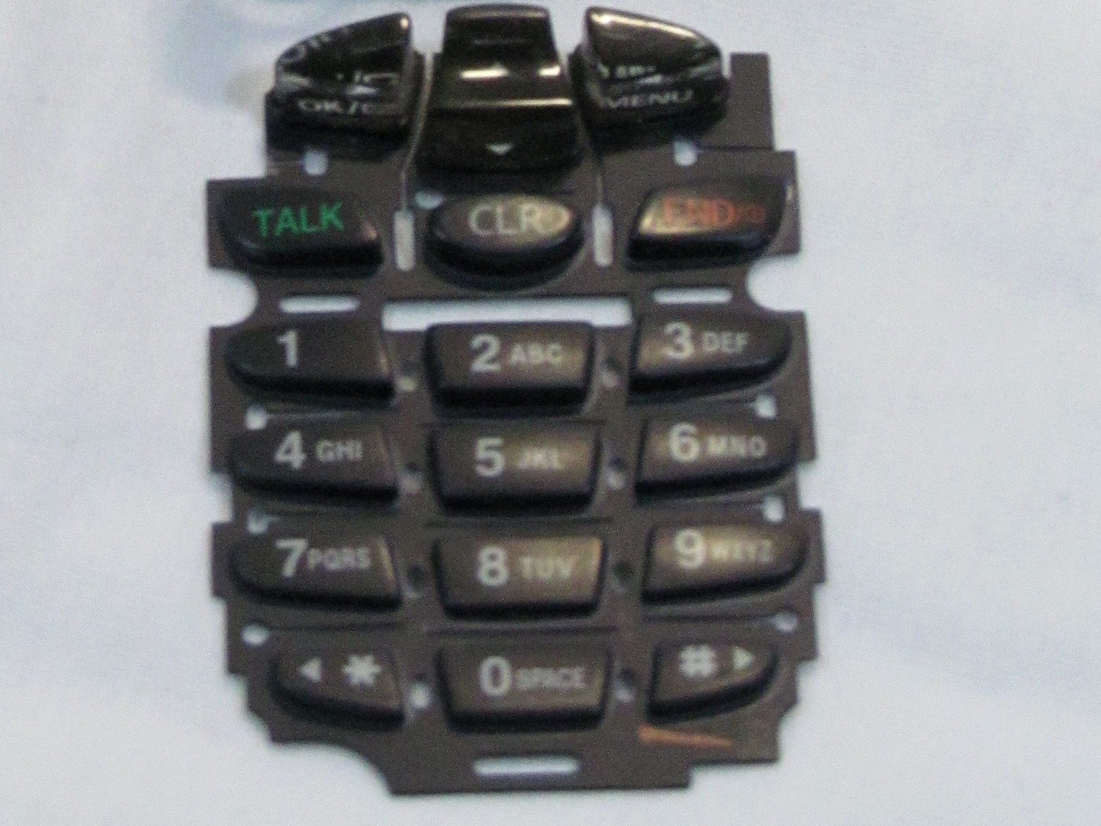

It is possible to remove the keypad after disassembly of the battery, antenna, back cover, and logic board. Once these parts are removed, the keypad should simply slide out from its placement between the logic board and the front cover.

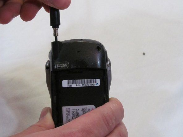

  • Grasp antenna firmly and rotate counterclockwise to unscrew it from the phone.
Image #1
Add Note Edit Step 5  ¶

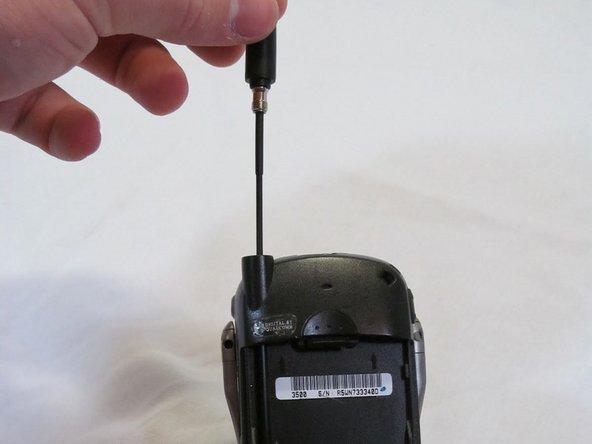

  • When unscrewed, pull the antenna straight up and out.
Image #1 Image #2

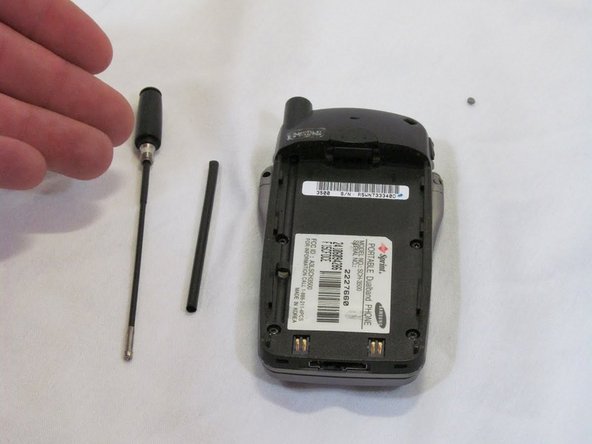

  • Pull guide tube free from its retaining ring and slide it out the top, like the antenna (optional).
  • The antenna and its guide tube are now removed from the phone. Congratulations.

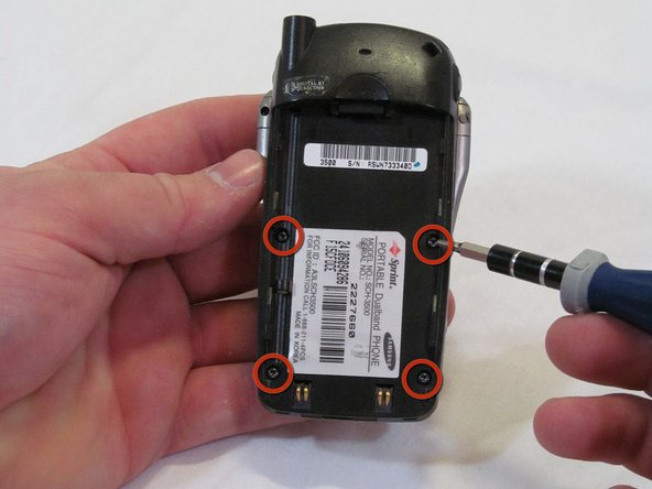

  • Remove the four screws using a T6 Torx screwdriver.
Image #1 Image #2

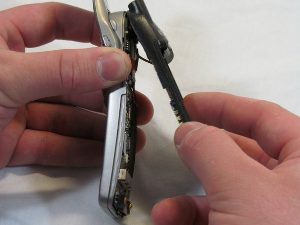

  • Work from the bottom of the phone, separating the two halves of the case.
  • Note: Take care to keep the logic board with the front case half. Part of the logic board is exposed to the sticker under the battery on the rear case half.
