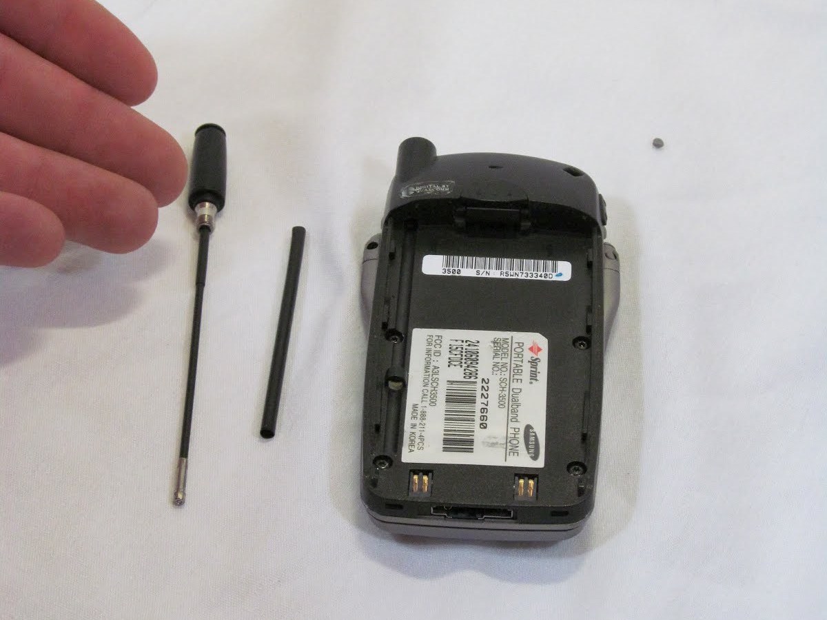

Antenna Installation is also straightforward, requiring no tools, but does require prior battery removal knowledge. During antenna installation, make sure to remove both the antenna and guide tube for completion.

  • Turn Samsung SCH3500 around so that the back is facing you. Depress locking tab on the back of the phone with a finger or thumb.
Image #1
Add Note Edit Step 2  ¶
  • Slide battery toward bottom of the phone, ~1/4 inch, to clear the hooks that keep it secured to the back of the phone.
Image #1
Add Note Edit Step 3  ¶
  • Lift battery away from phone case.
  • The battery is now removed from the device. Congratulations.
Image #1 Image #2
Add Note Edit Step 4 — Antenna  ¶
  • Grasp antenna firmly and rotate counterclockwise to unscrew it from the phone.
Image #1
Add Note Edit Step 5  ¶
  • When unscrewed, pull the antenna straight up and out.
Image #1 Image #2
Add Note Edit Step 6  ¶
  • Pull guide tube free from its retaining ring and slide it out the top, like the antenna (optional).
  • The antenna and its guide tube are now removed from the phone. Congratulations.
