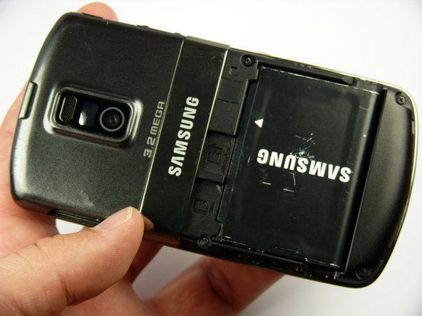

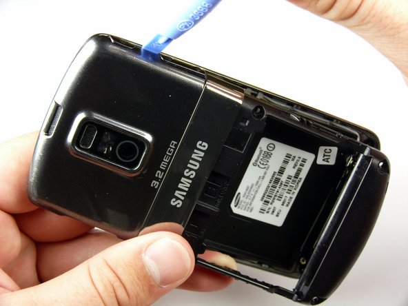

  • Slide the battery cover downwards with pressure focused on the center of the cover.
  • Lift the cover off of the phone.

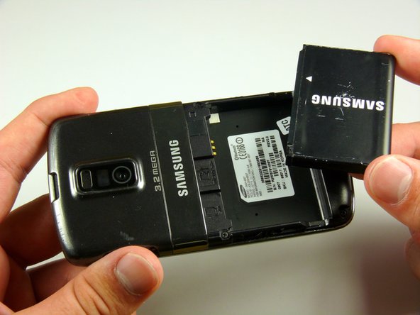

  • Grasp the bottom left and right corners of the battery and lift it from its housing.

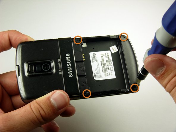

  • Remove the four black 7.30 mm screws surrounding the battery housing using a Phillips #00 Screwdriver.

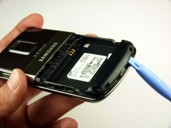

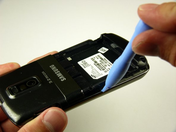

Add Note Edit Step 4  ¶
  • The rear case is firmly attached to the phone with clips. Do not be afraid to use a little extra force.
  • Insert the Plastic Opening Tool in between the front and rear cases.
  • Pry with the Plastic Opening Tool around all edges of the phone until you free all the clips.

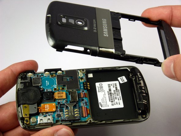

Add Note Edit Step 5  ¶
  • Lift the rear case off of the phone.
Image #1

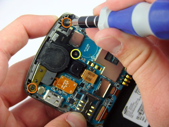

Add Note Edit Step 6 — Speaker  ¶
  • Remove the two black 7.30 mm screws on the top right and left corners of the Motherboard using a Phillips #00 Screwdriver.
  • Remove the silver 4.50 mm screw located below the speaker using a Phillips #00 Screwdriver.
Image #1 Image #2

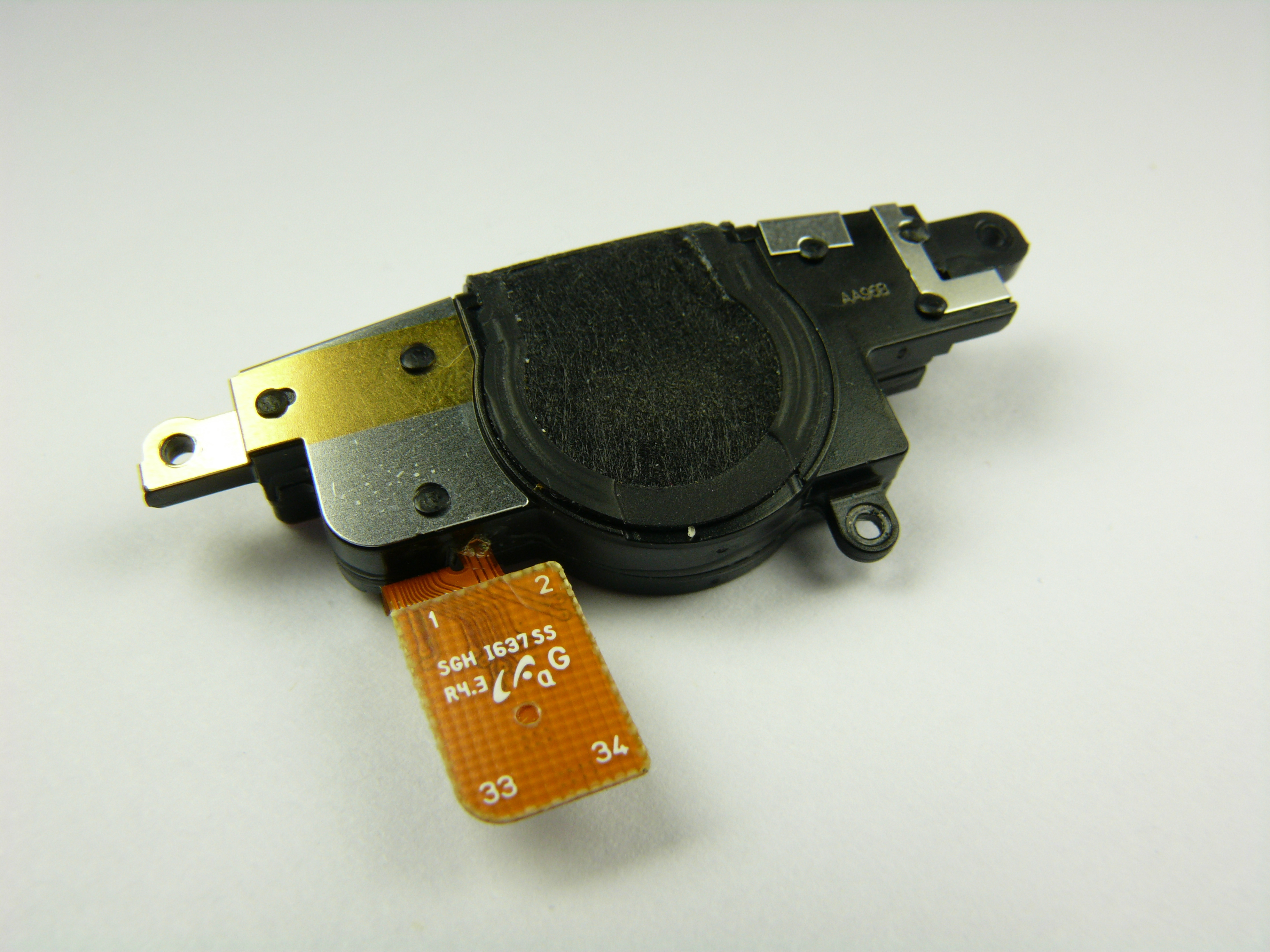

Add Note Edit Step 8  ¶
  • Lift the speaker out of its compartment.
