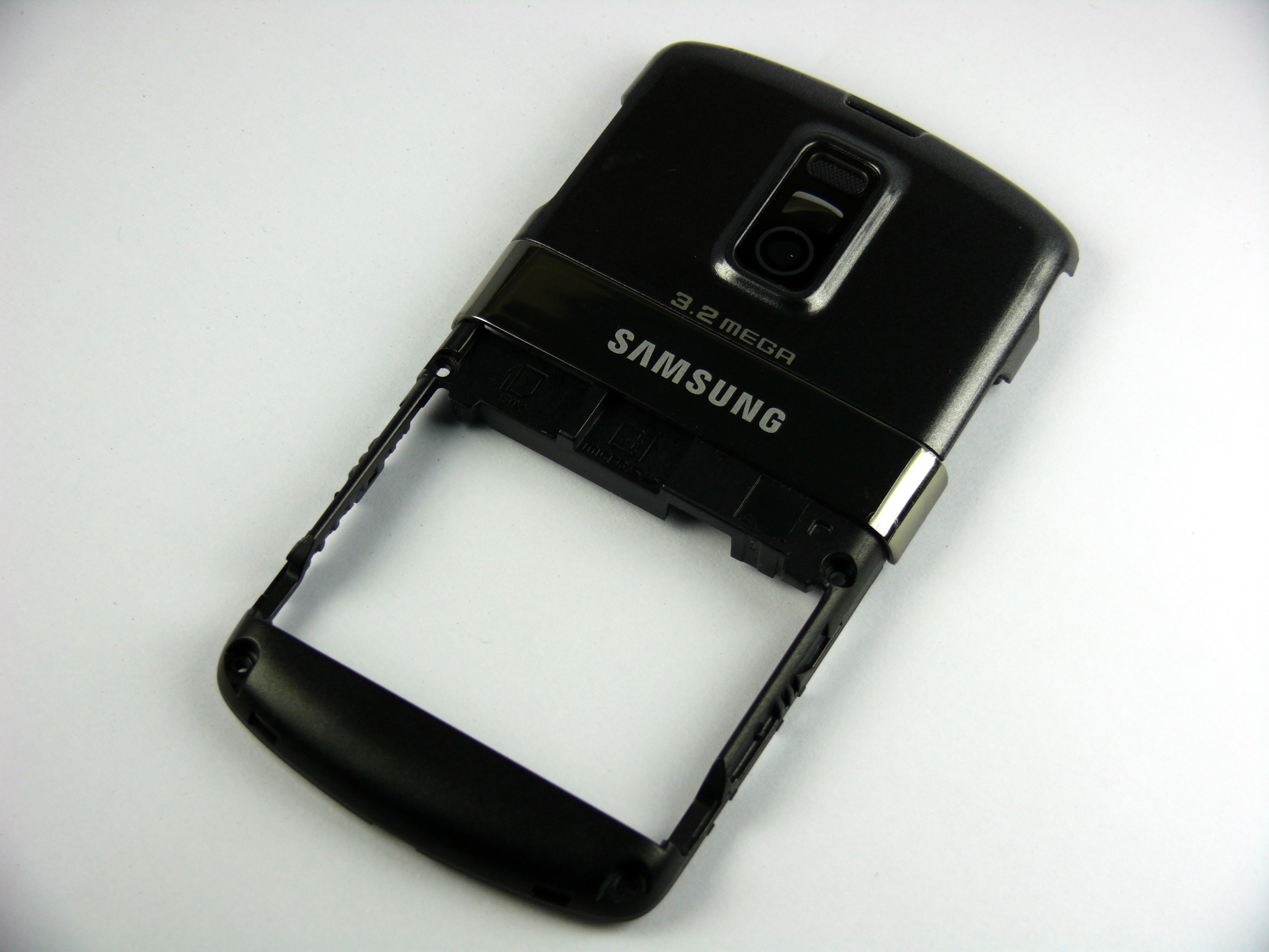

Use this guide to install a rear case.
Image #1
  • Slide the battery cover downwards with pressure focused on the center of the cover.
  • Lift the cover off of the phone.
Image #1
Add Note Edit Step 2  ¶
  • Grasp the bottom left and right corners of the battery and lift it from its housing.
Image #1
Add Note Edit Step 3 — Rear Case  ¶
  • Remove the four black 7.30 mm screws surrounding the battery housing using a Phillips #00 Screwdriver.
Image #1 Image #2 Image #3
Add Note Edit Step 4  ¶
  • The rear case is firmly attached to the phone with clips. Do not be afraid to use a little extra force.
  • Insert the Plastic Opening Tool in between the front and rear cases.
  • Pry with the Plastic Opening Tool around all edges of the phone until you free all the clips.
Image #1
Add Note Edit Step 5  ¶
  • Lift the rear case off of the phone.
