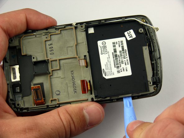

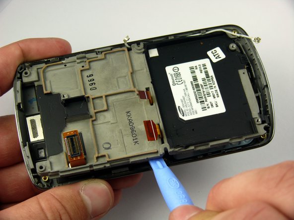

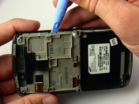

Add Note Edit Step 17 — LCD  ¶
  • The LCD frame is firmly attached to the phone with clips. Do not be afraid to use a little extra force.
  • Insert the Plastic Opening Tool between the LCD frame and the front case of the phone.
  • Slide the Plastic Opening Tool around the LCD frame to detach all of the clips.

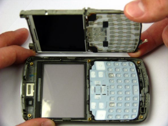

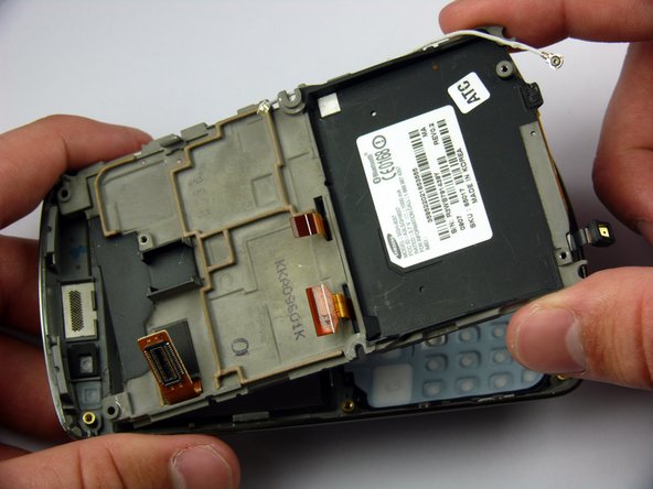

Add Note Edit Step 18  ¶
  • Lift up the LCD frame.

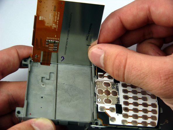

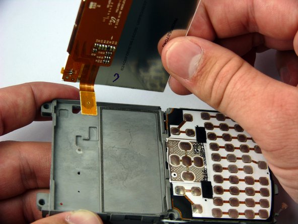

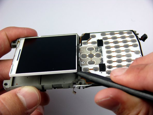

Add Note Edit Step 19  ¶
  • There is a hanging ribbon cable connected to the LCD screen that passes through the LCD frame.
  • Insert the spudger under the bottom left corner of the LCD screen.
  • Use the spudger to gently pry the LCD screen out of its frame.
  • Gently remove the screen from the frame.
