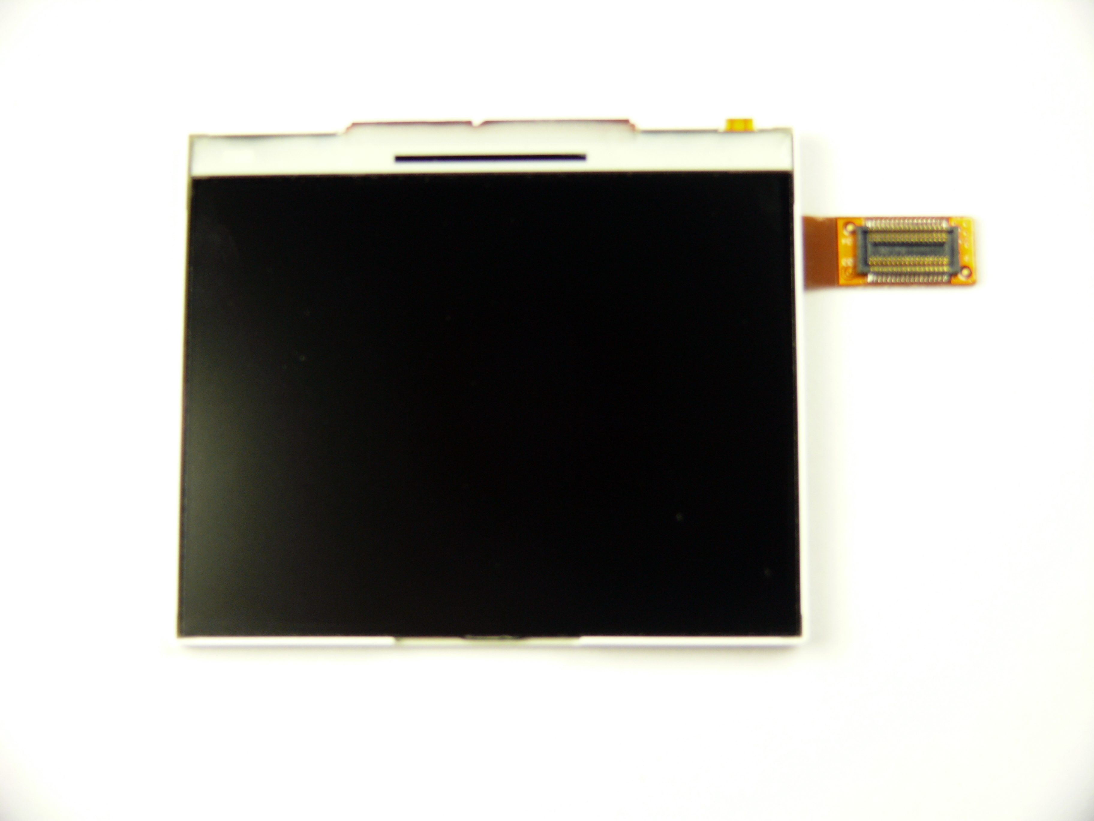

Add Note Edit Step 15  ¶
  • There is a ribbon cable under the Motherboard connecting it to the LCD. Do not pull off the Motherboard just yet.
  • Insert the Plastic Opening Tool under the upper left corner of the Motherboard to help reveal the ribbon cable.
  • Use a spudger to disconnect the Motherboard ribbon cable.
Image #1
Add Note Edit Step 16  ¶
  • Lift the Motherboard off of the phone.
