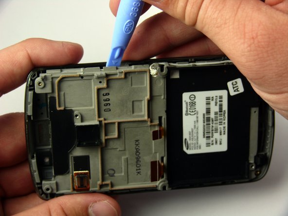

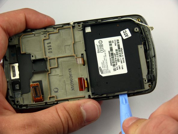

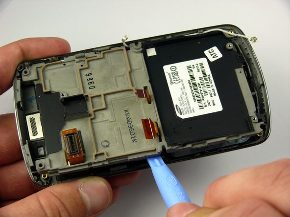

  • The LCD frame is firmly attached to the phone with clips. Do not be afraid to use a little extra force.

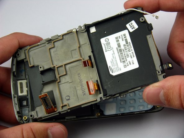

  • Insert the Plastic Opening Tool between the LCD frame and the front case of the phone.
  • Slide the Plastic Opening Tool around the LCD frame to detach all of the clips.
Image #1 Image #2
Add Note Edit Step 18  ¶

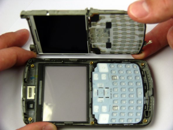

  • Lift up the LCD frame.

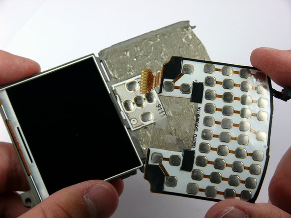

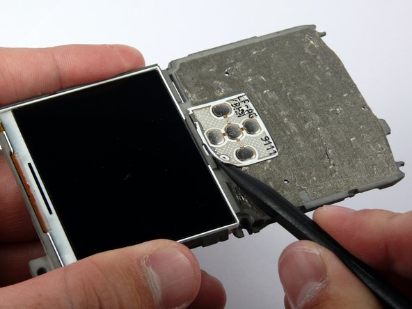

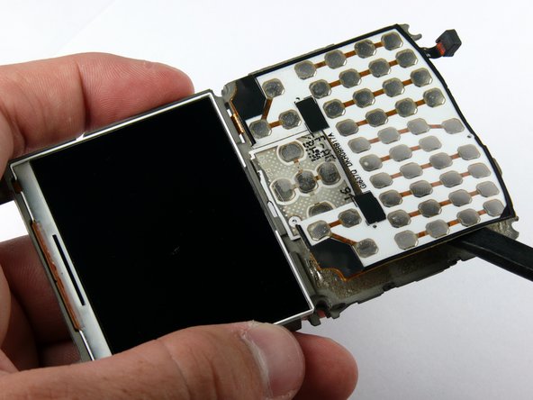

  • The keyboard ribbon cable passes through the LCD frame. Be careful not to rip the ribbon cable when removing the keyboard.
  • The keyboard and directional keys are glued separately to the LCD frame.
  • Insert the spudger between the keyboard and the frame.
  • Peel the keyboard off by sliding the spudger back and forth across the LCD frame.

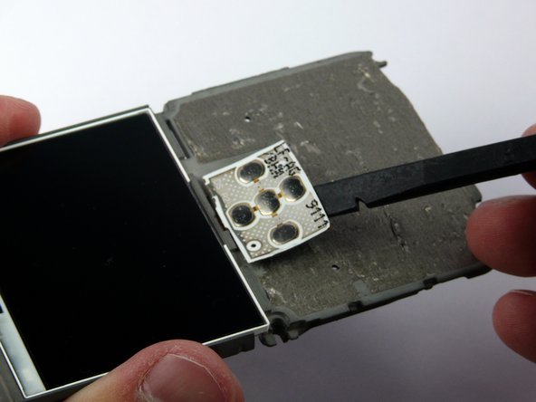

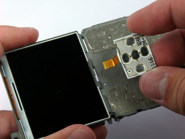

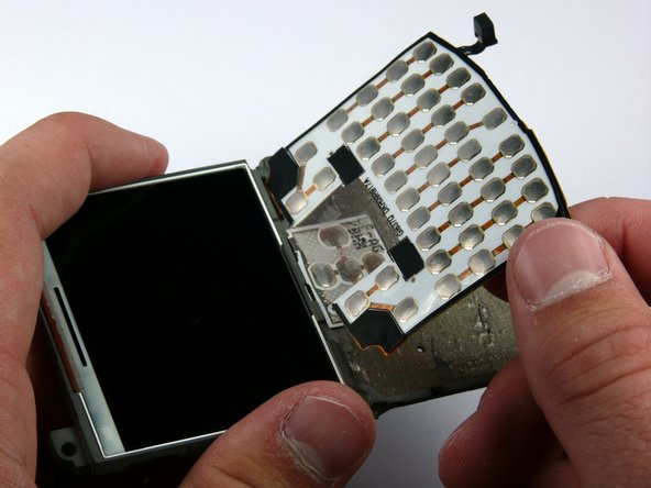

  • Insert the spudger between the directional keys and the frame.
  • Peel the directional keys off by sliding the spudger back and forth across the LCD frame.
