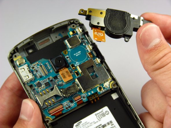

Add Note Edit Step 9  ¶
  • Use the spudger to detach the speaker ribbon cable.
Image #1
Add Note Edit Step 10  ¶
  • Lift the speaker out of its compartment.
Image #1

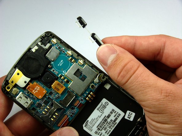

Add Note Edit Step 11 — Motherboard  ¶
  • Remove the power and volume buttons on the right side of the Motherboard.
Image #1 Image #2

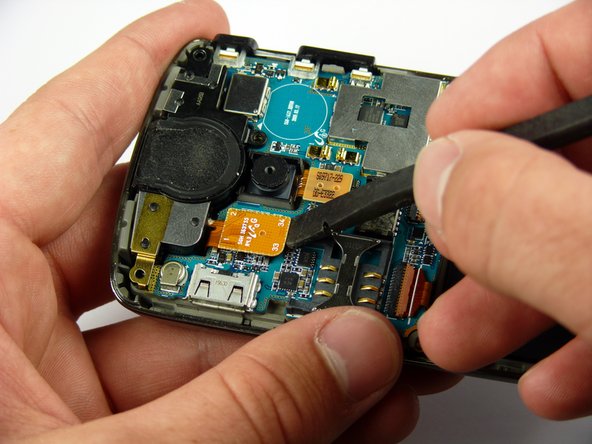

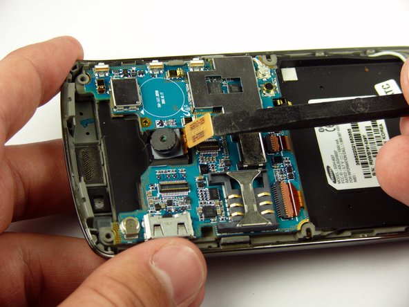

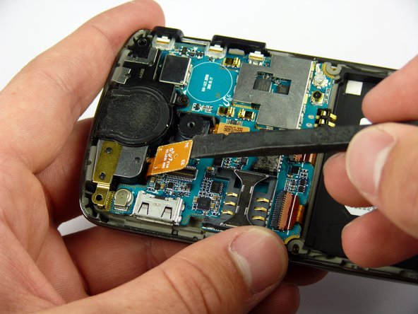

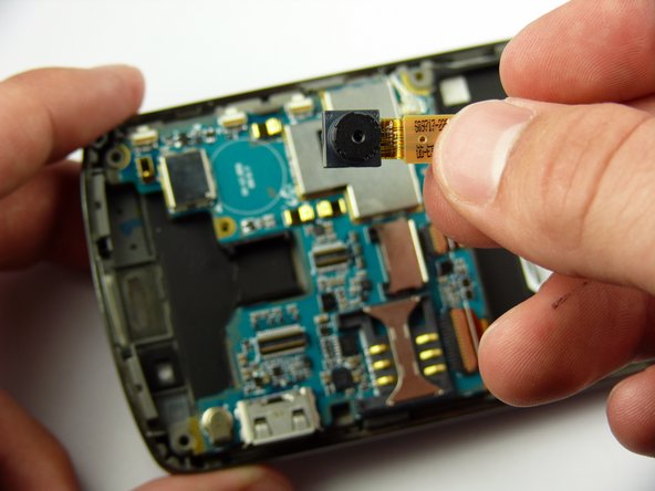

Add Note Edit Step 12  ¶
  • Use a spudger to detach the camera ribbon cable.
  • Lift the camera off of the Motherboard.
Image #1 Image #2

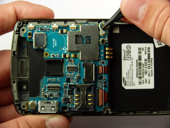

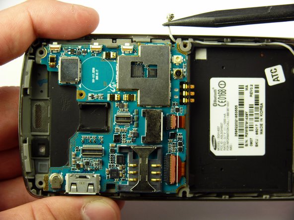

Add Note Edit Step 13  ¶
  • Use a spudger to disconnect the white antenna wire on the bottom right corner of the Motherboard.
Image #1 Image #2 Image #3

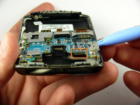

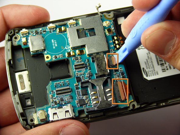

Add Note Edit Step 14  ¶
  • Use a Plastic Opening Tool to lift the flaps of the ZIF connectors to release the ribbon cables near the bottom of the Motherboard.
  • Use a spudger to carefully pull the ribbon cables away from the ZIF connectors.

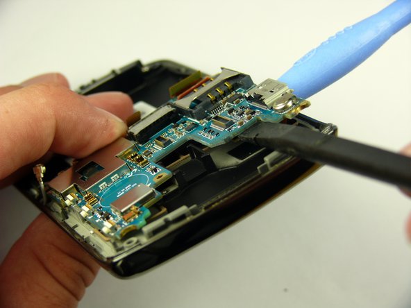

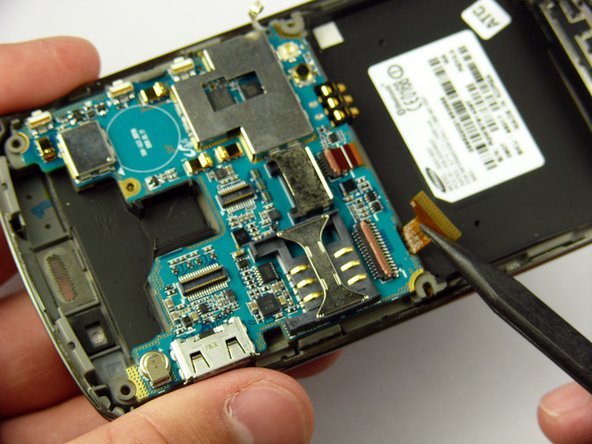

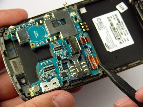

Add Note Edit Step 15  ¶
  • There is a ribbon cable under the Motherboard connecting it to the LCD. Do not pull off the Motherboard just yet.
  • Insert the Plastic Opening Tool under the upper left corner of the Motherboard to help reveal the ribbon cable.
  • Use a spudger to disconnect the Motherboard ribbon cable.
Image #1
Add Note Edit Step 16  ¶
  • Lift the Motherboard off of the phone.
