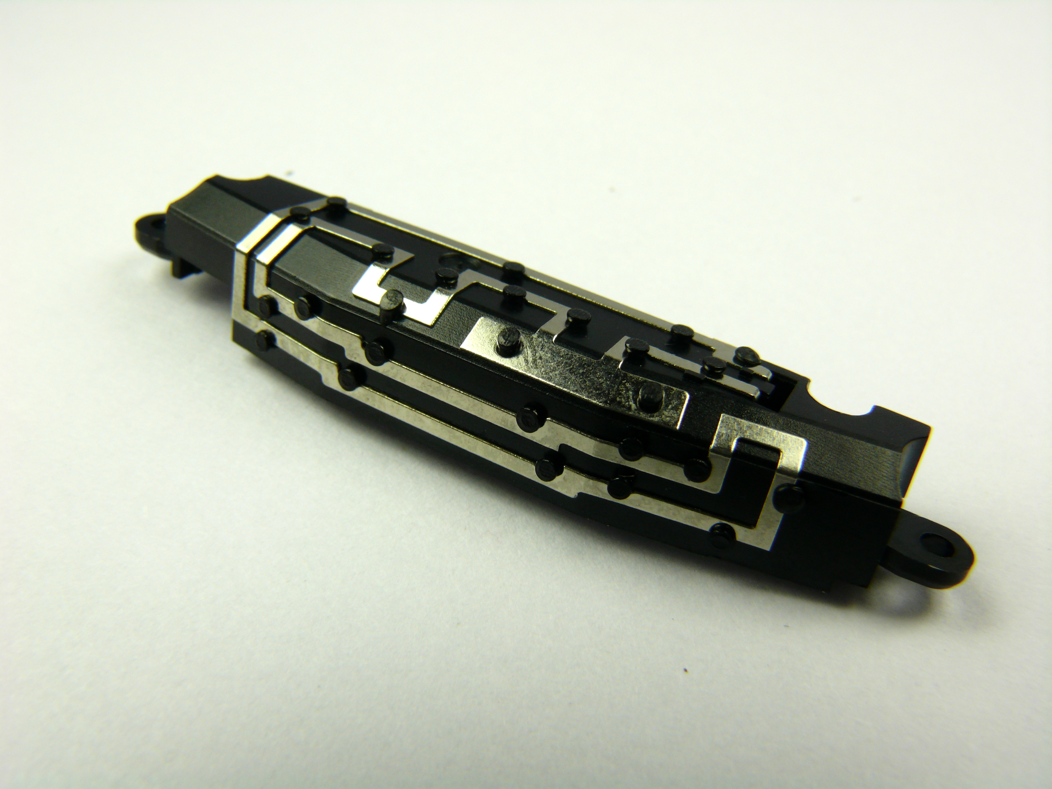

Add Note Edit Step 6 — Antenna  ¶
  • Remove the two silver 4.30 mm screws on either side of the antenna using a Phillip's #00 Screwdriver.
Image #1 Image #2 Image #3
Add Note Edit Step 7  ¶
  • There is a wire under the antenna connecting it to the Motherboard. Do not pull off the antenna just yet.
  • Use a spudger to remove the wire connector under the antenna.
