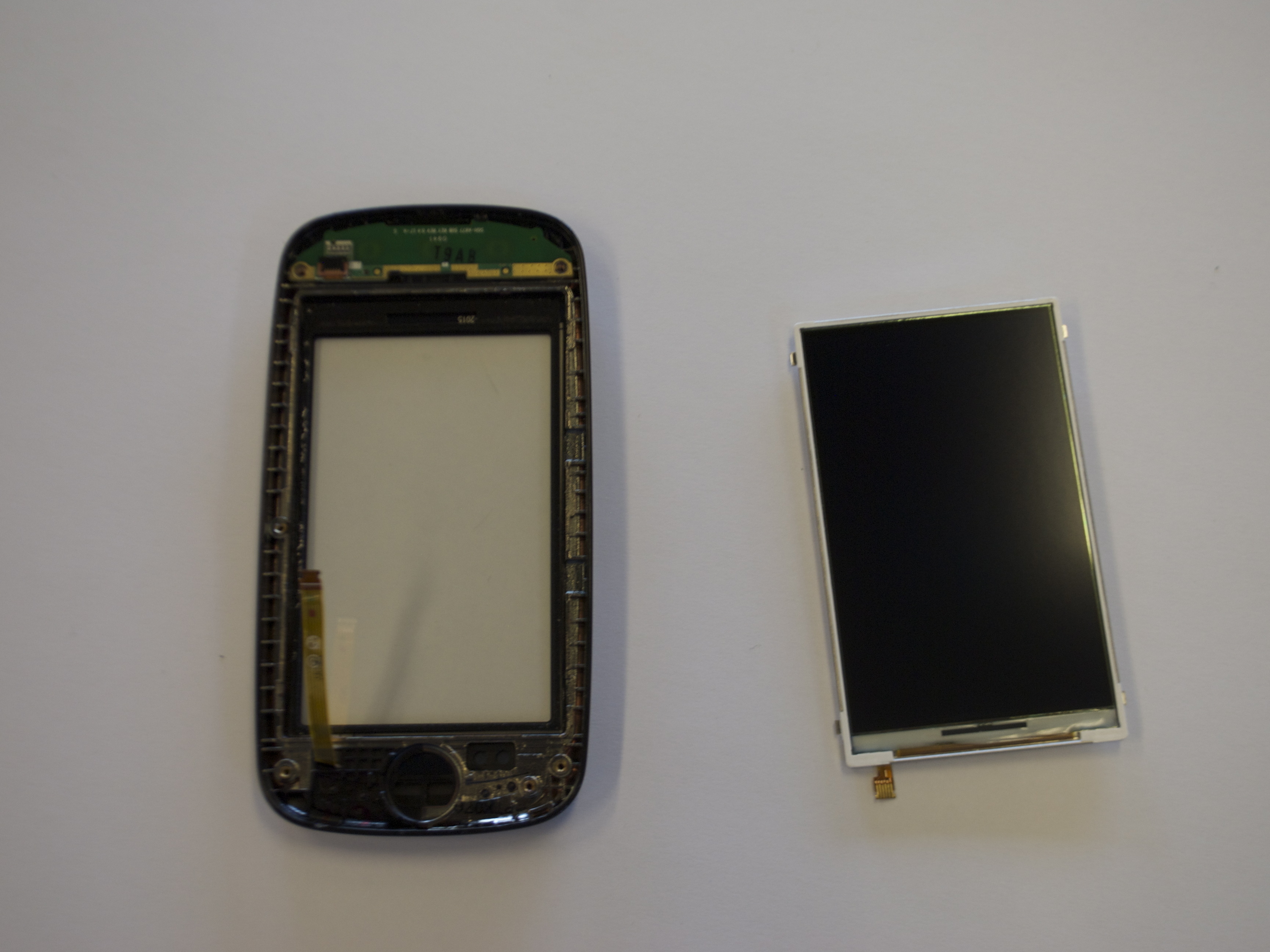

How to remove & replace the phone's LCD screen.
Sections
Image #1
  • Orient the phone with the screen facing down.
  • Using your thumb, slide the back panel away from the camera to expose the battery.
Image #1 Image #2
Add Note Edit Step 2  ¶
  • Grip the battery on its sides, opposite the direction of the white arrow.
  • Pry the battery up. It will pivot at the end with the white arrow. The battery will now be free.
Image #1
Add Note Edit Step 3 — Back Cover  ¶
  • Remove the 6 outer screws.
    • The screws should be 3.5 mm in length.
  • Put the screws in a safe place as they are very small and easy to lose.
Image #1
Add Note Edit Step 4  ¶
  • Snap off back the cover by gently prying around the top and bottom edges with a flat head screwdriver.
    • It may help to slide the touchscreen upwards when removing the back panel.
  • The side buttons will become loose and are prone to fall out, so put these in a safe place.
Image #1
Add Note Edit Step 5 — Circuit Board  ¶
  • To free the circuit board, remove the black wire that is holding it down.
    • You can remove the wire by gently prying up the gold terminator that is attached to the green circuit board. A gentle tug is all it will take.
Image #1 Image #2
Add Note Edit Step 6  ¶
  • The circuit board will still be held on by a blue and black ribbon that is removed by gently pulling it upwards.
Image #1
Add Note Edit Step 7 — Keyboard  ¶
  • Remove the two base screws along the edge of the silver piece, where you just removed the black end piece.
    • The screws are 2.7mm in length.
  • The bottom black end cap will snap out.
Image #1 Image #2
Add Note Edit Step 8  ¶
  • Remove 6 screws holding the silver plate on.
    • 2.7mm in length
  • The keys will peel right out of the screen side of the phone.
