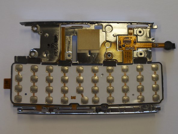

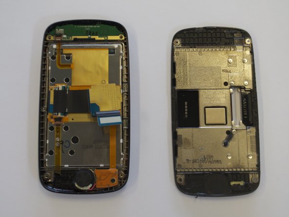

  • The silver piece you are left with is the physical keyboard assembly.
Image #1 Image #2

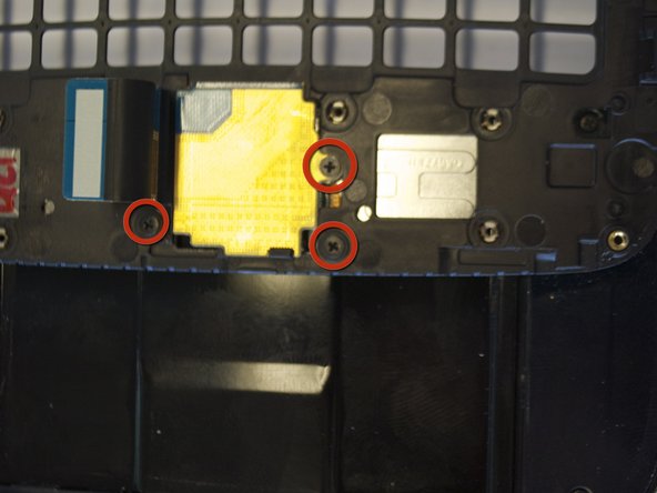

Add Note Edit Step 10 — LCD Flex Cable  ¶
  • Remove the 3 screws holding down the flex cable.
    • The screws are 2.0 mm in length.
    • The screw that goes through the circle port on the flex cable is longer at 2.3mm long.
  • The keyboard slider frame will come off and the flex cable exposed, but not free.
Image #1
Add Note Edit Step 11  ¶
  • Remove 4 outer screws.
    • The screws are 3.5mm in length.

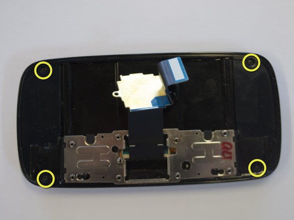

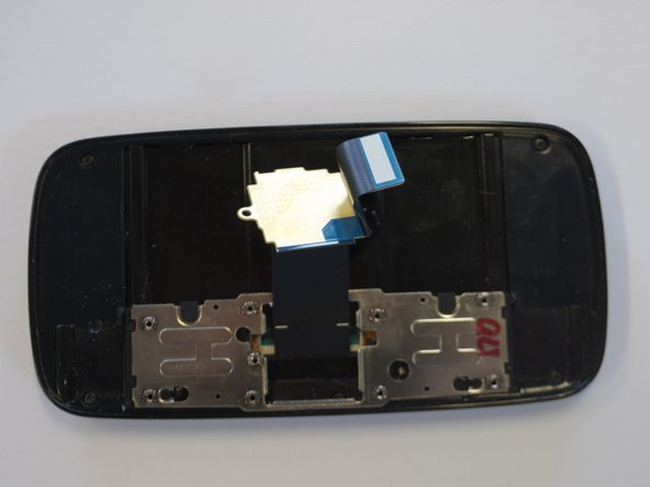

Image #1 Image #2 Image #3
Add Note Edit Step 12  ¶
  • Slide the phone apart, and remove a 5th screw (3.5 mm).
  • Remove the outer shell by prying the edges off with your fingers, or a small screwdriver. (second image, taken before the image for above instruction)
  • The device will now be in two pieces

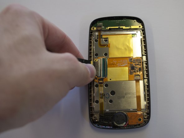

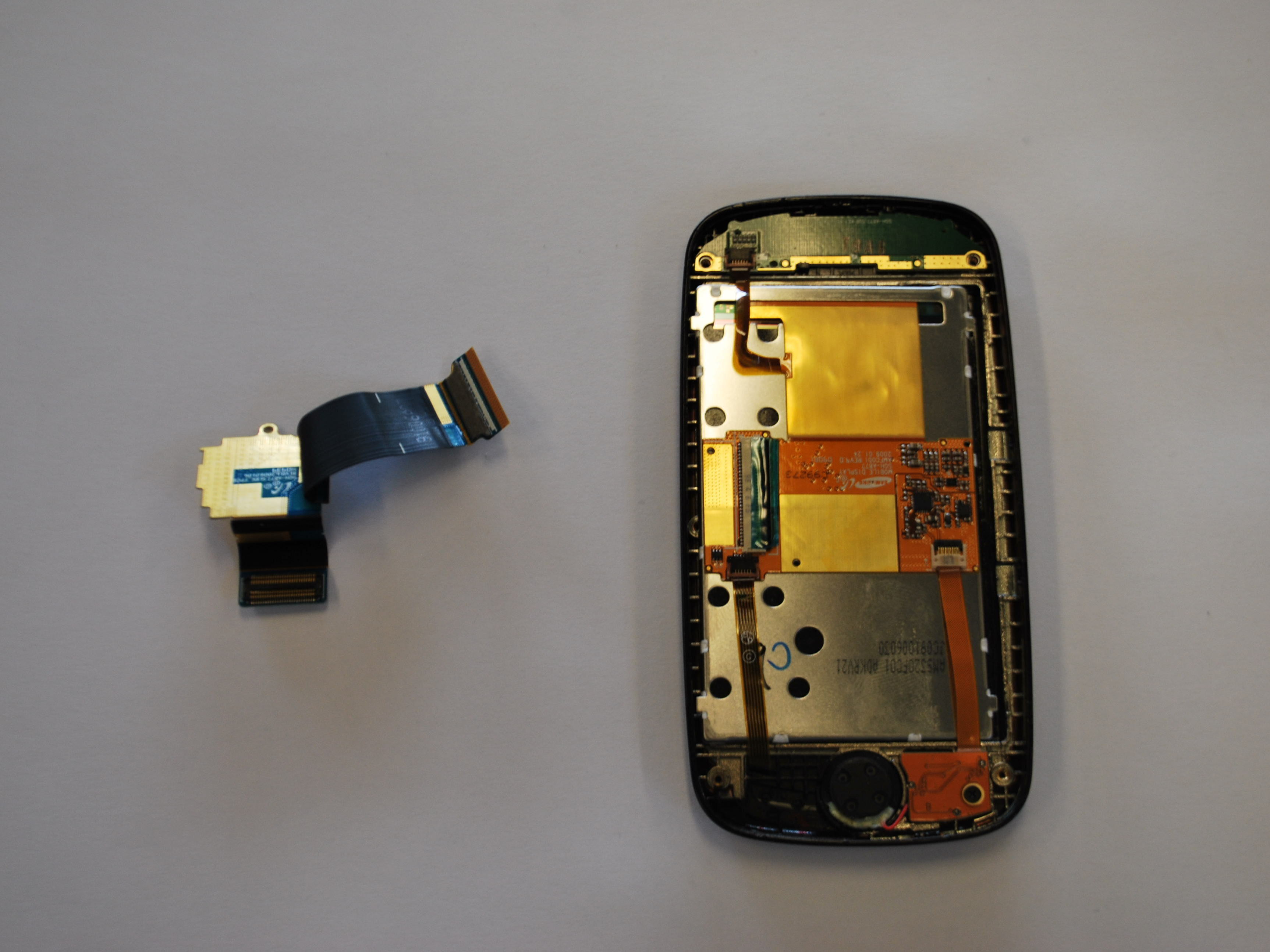

Image #1 Image #2
Add Note Edit Step 13  ¶
  • Lift the tab underneath the blue tape and gently pull the flex cable.
  • The flex cable will now be completely free.
