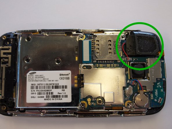

Add Note Edit Step 5 — Back Speaker  ¶
  • Remove the back speaker by carefully lifting it up.
  • The speaker will still be attached to the circuit board by a wire and a small piece of clear plastic.
  • Disconnect the speaker by lifting the clear plastic piece at the end of the wire.
Image #1

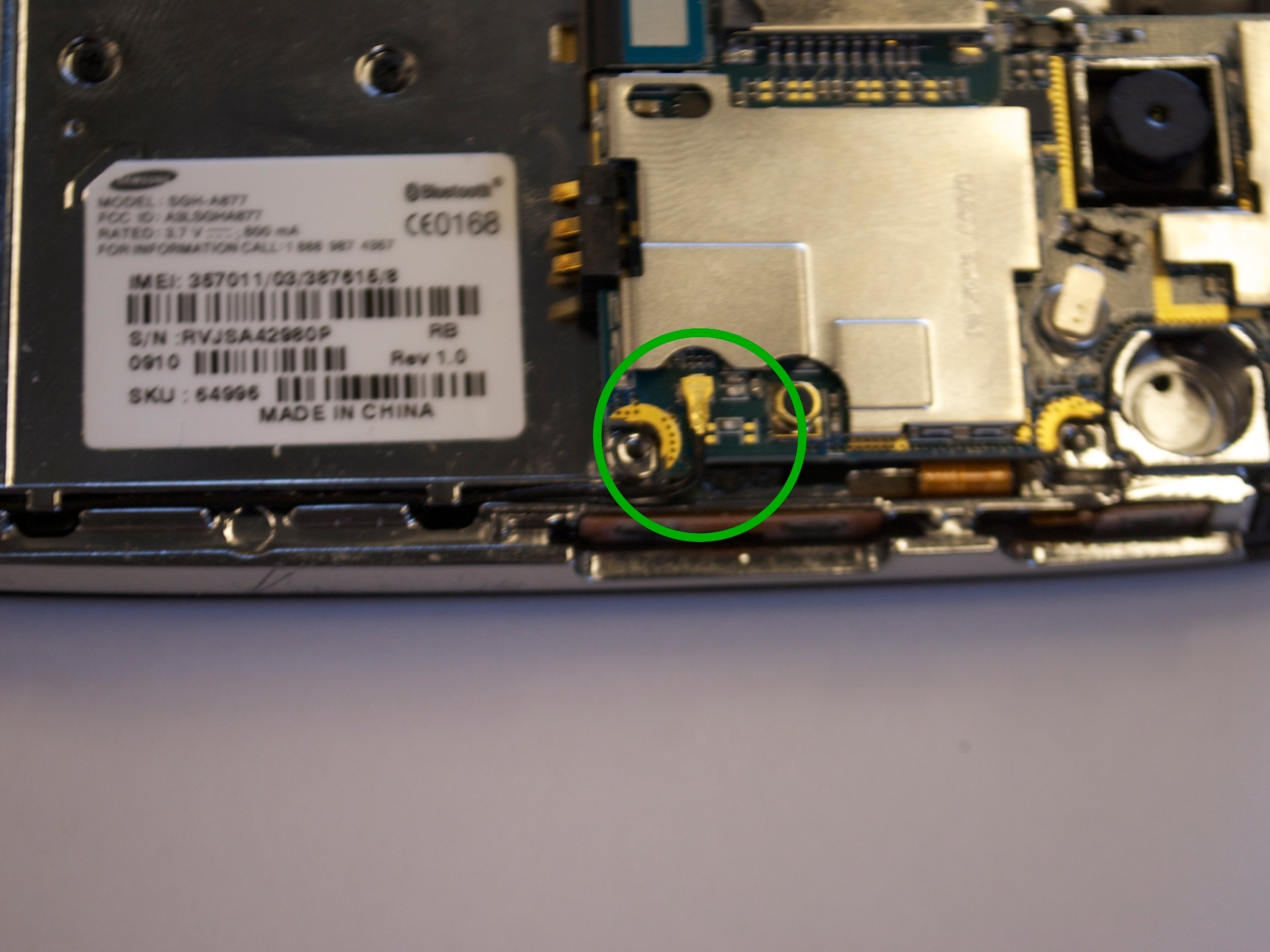

Add Note Edit Step 6 — Circuit Board  ¶
  • To free the circuit board, remove the black wire that is holding it down.
    • You can remove the wire by gently prying up the gold terminator that is attached to the green circuit board. A gentle tug is all it will take.
Image #1 Image #2
Add Note Edit Step 7  ¶
  • The circuit board will still be held on by a blue and black ribbon that is removed by gently pulling it upwards.
