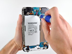

Use this guide to replace the battery.

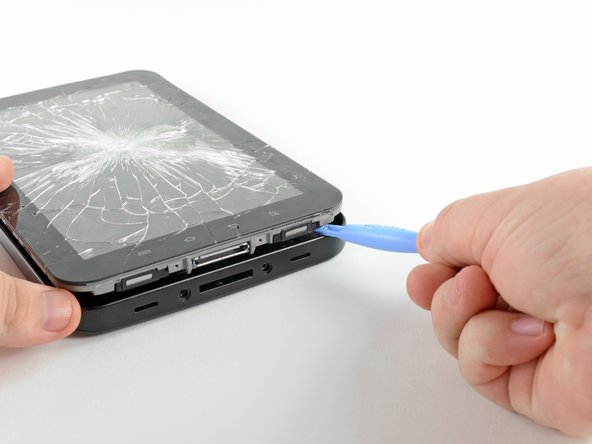

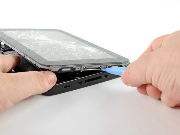

Add Note Edit Step 1 — Front Panel  ¶

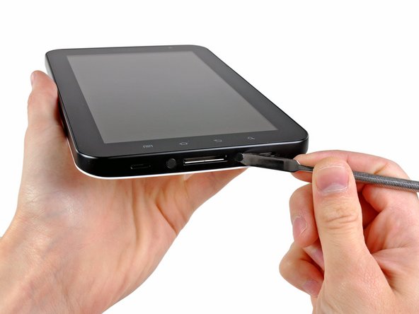

  • Use the flat end of a metal spudger to pry the two plastic tabs near the dock connector off the rear case.
Image #1
Add Note Edit Step 2  ¶

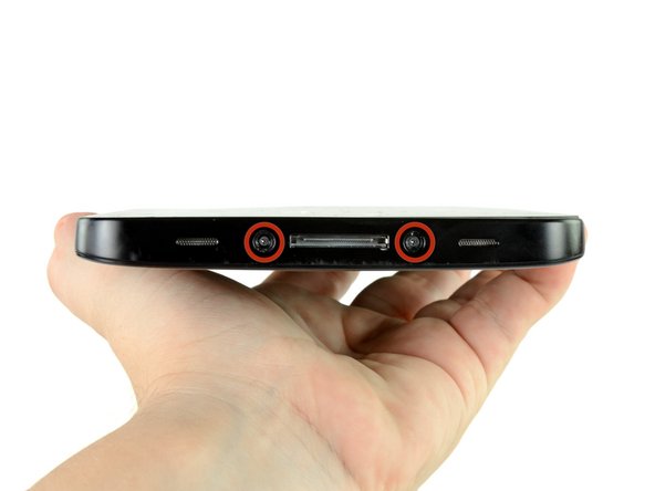

  • Remove the two 4.1 mm Tri-Wing screws near the adjacent edges of the dock connector.
Image #1
Add Note Edit Step 3  ¶

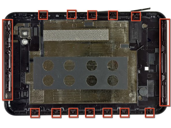

  • The following steps will require you to disengage several clips (highlighted in red) around the perimeter of the rear case. The clips are delicate and fragile; proceed with caution.

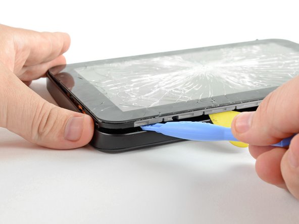

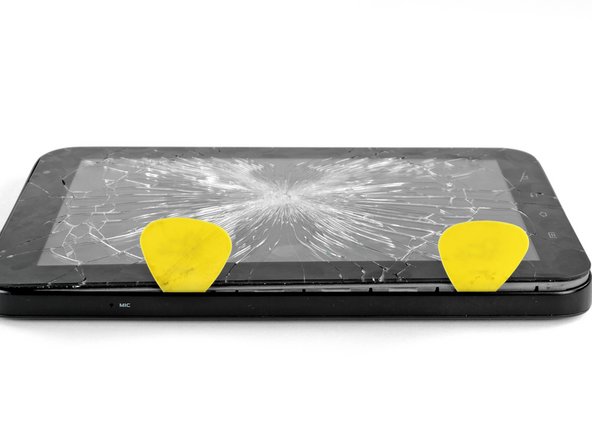

Add Note Edit Step 4  ¶
  • Disclaimer: The Galaxy Tab we acquired already had a shattered front glass panel. However, the procedure outlined in this guide is identical for both intact/shattered front panels.

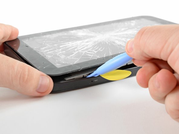

  • Insert a plastic opening tool near the bottom left edge of the rear case.
  • Use your plastic opening tool to gently create a small gap between the front panel and the rear panel near the bottom left edge.
  • Run the plastic opening tool along the left side of the perimeter to create a bigger gap between the front panel and the rear panel.
  • Insert two guitar picks into the small gap created by the plastic opening tool.

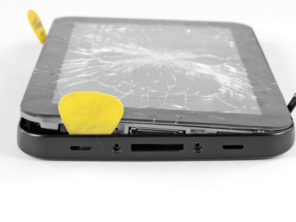

  • Insert the plastic opening tool into the dock connector and wedge it underneath the front panel/motherboard assembly.
  • Thrust the plastic opening tool downwards to create a gap near the lower left corner of the front panel assembly.
  • Insert a guitar pick into the newly created gap near the lower left edge of the Galaxy Tab.

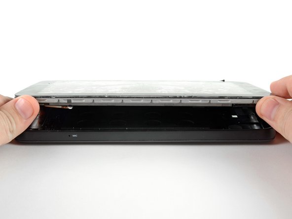

Add Note Edit Step 6  ¶

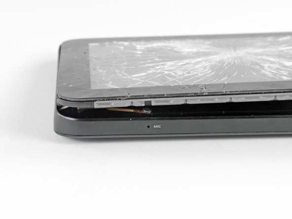

  • Be careful when approaching the top left corner of the Galaxy Tab. Be sure to follow the next step carefully.
  • When separating the front panel from the top left corner of the Galaxy Tab, be careful not to rip the microphone ribbon cable (highlighted in red in the first picture). It is extremely thin and easy to tear.
  • Insert a plastic opening tool into the gap next to the left side of the guitar pick.
  • Make sure to wedge it underneath the inner framework to gain the most leverage when releasing the clips.
  • Simultaneously lift upwards and run the plastic opening tool along the top left corner of the Galaxy Tab to free the Front Panel Assembly from the retaining clips.

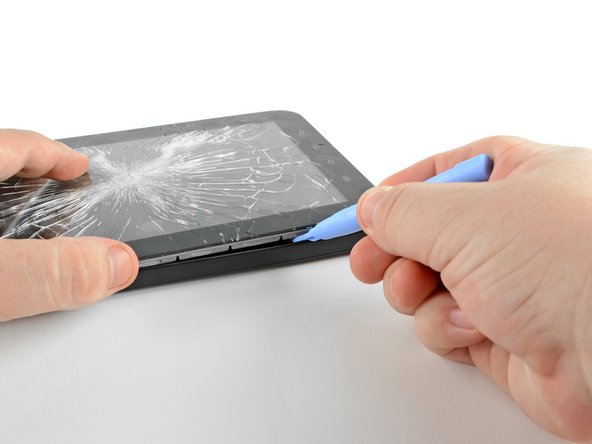

Add Note Edit Step 8  ¶
  • Wedge the flat edge of an opening tool between the front panel and rear panel near the dock connector.
  • Use a plastic opening tool to pry the bottom right corner out of its housing in the rear panel.
