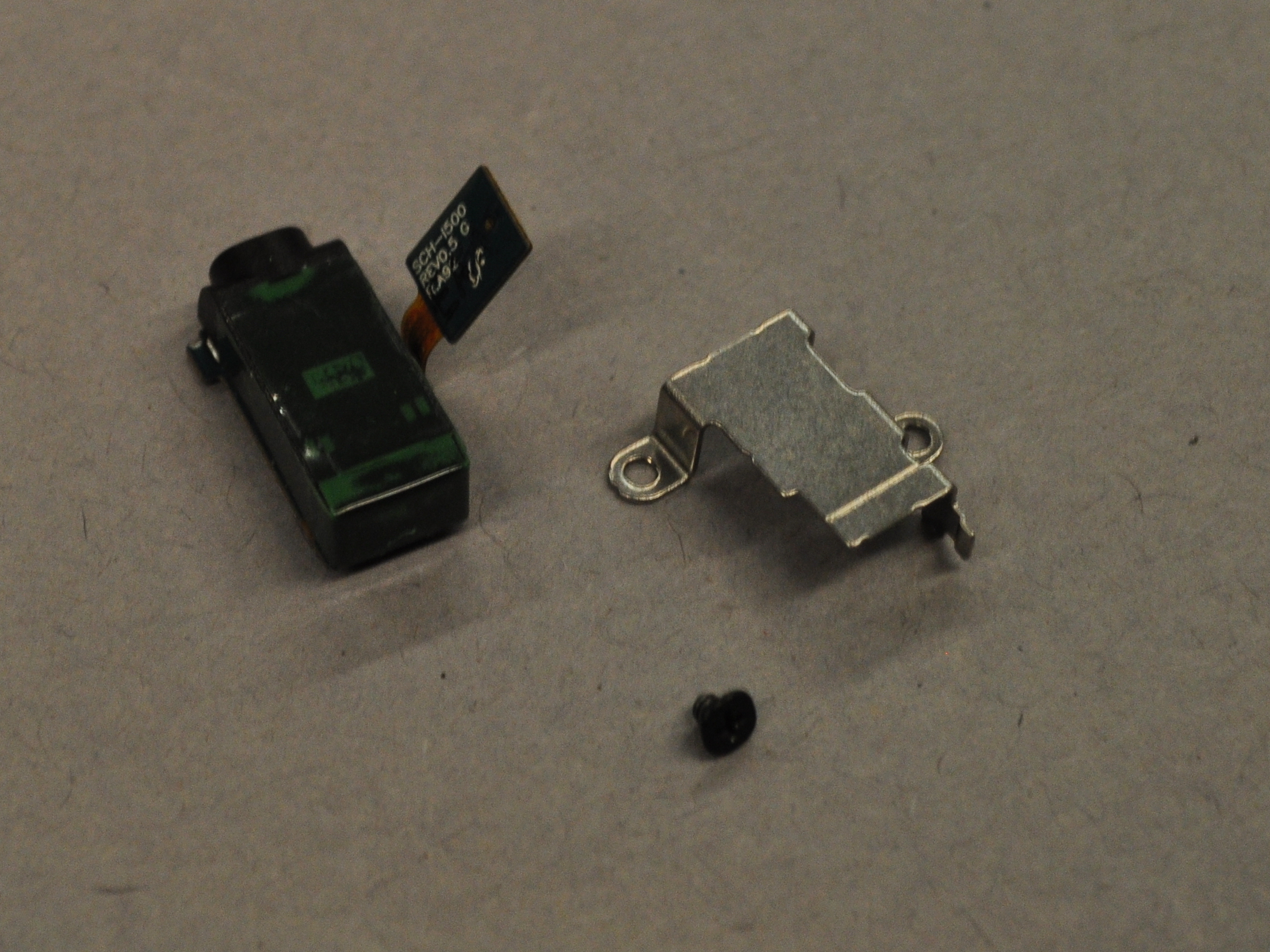

This guide will show you how to disassemble the Samsung Galaxy S SCH-i500 so that you can access the Headphone Jack/Audio Output device.
You will need to remove the Headphone Jack/Audio Output device in order to remove/install this component.
Image #1 Image #2 Image #3

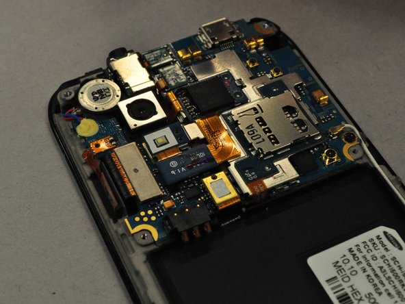

Image #1 Image #2
  • Insert the spudger into the space between the battery and the phone and pry the battery out as you slide it along the underside the battery.

  • Use the screwdriver to unscrew each of the 6 silver screws holding the main case to the LCD touchscreen.
  • If the screws are stuck, use the spudger to pry them out.

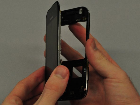

  • Use the plastic opening tool to pry the main case from the LCD touchscreen.
  • Insert the thin edge of the plastic opening tool into the groove between the silver edge and black edge.
  • Run the tool all the way around the edge of the phone until you hear each of the clips detach.

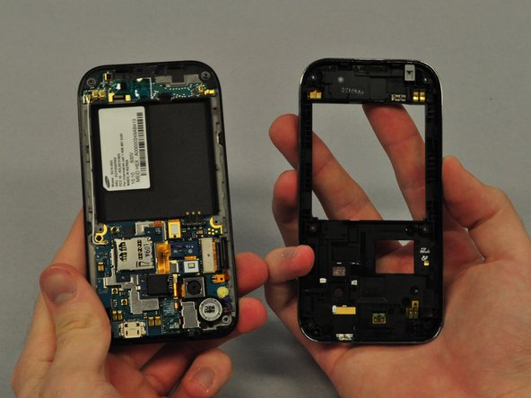

  • Once the clips are detached, separate the main case from the LCD touchscreen.

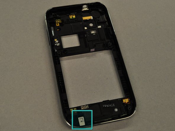

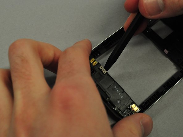

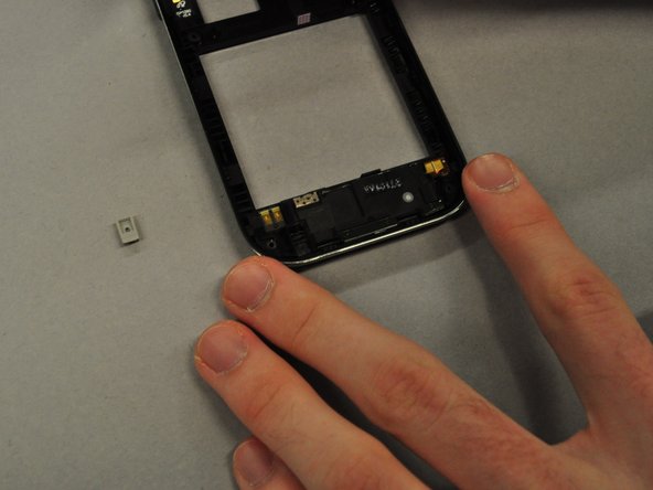

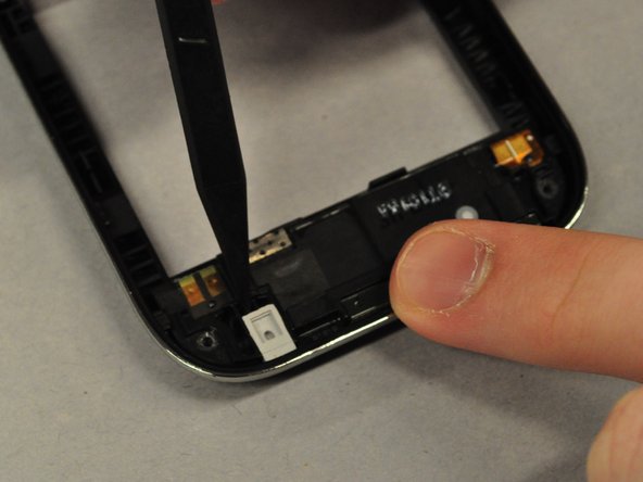

  • Use the spudger to pry out the grey rubber rectangular component from the main case.
Add Note Edit Step 8  ¶

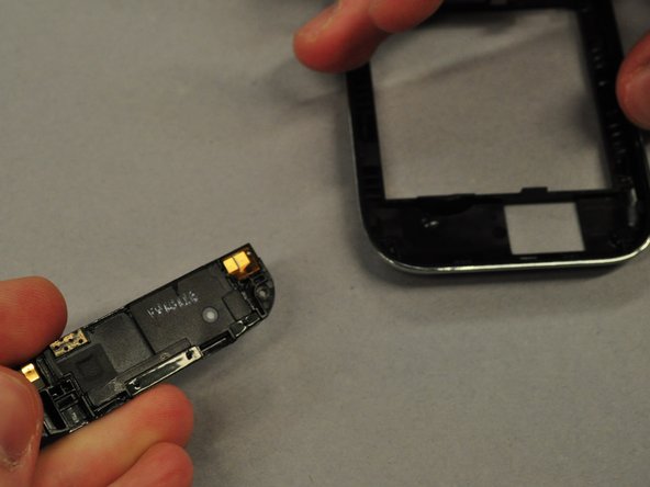

  • Use the spudger to pry along the groove between the speaker and the main case.
  • Once the speaker is unclipped it should pop out easily.
