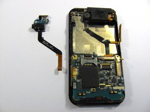

This guide will show you step-by-step instructions on how to remove the input jack from the phone to replace it with a new one.
  • Author: Sven
  • Time required: 15 to 30 minutes
  • Difficulty: Moderate
You will need to find a clean area to work in and have the necessary tools. Follow this guide to gain access to your cellphone's input jack module.

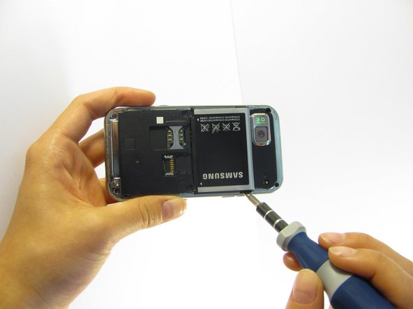

Add Note Edit Step 2  ¶
  • Remove the phone's battery.
Image #1

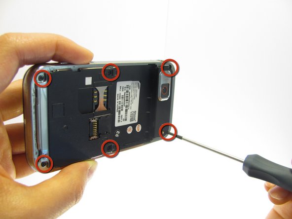

Add Note Edit Step 3  ¶
  • Remove six (4.28 x 1.25)mm screws.
Image #1 Image #2
Add Note Edit Step 4  ¶
  • Use the spudger to gently pry the silver plastic back plate from the body of the phone.
Image #1

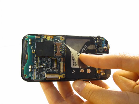

Add Note Edit Step 5 — Input Jack  ¶
  • Peel off the Identification sticker
Image #1

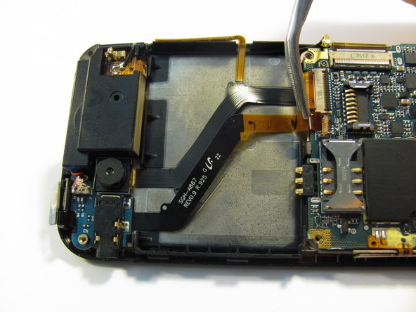

Add Note Edit Step 6  ¶
  • Pop the red hinged-release lever away from its ribbon, then slide the ribbon out.
Image #1

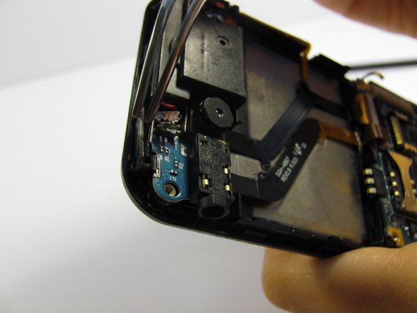

Add Note Edit Step 7  ¶
  • Pop the speaker plug out of its socket.
Image #1

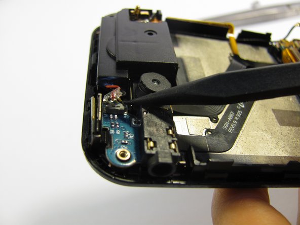

Add Note Edit Step 8  ¶
  • Peel the button sensor off the top of the case.
Next » « Previous
