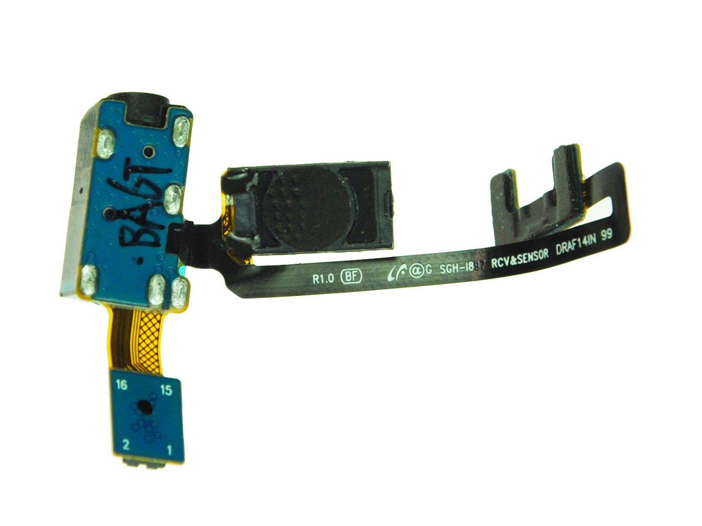

Replace the Captivate's 3.5mm headphone jack.
  • Author: Christopher
  • Time required: 15 to 30 minutes
  • Difficulty: Difficult
Use this guide to replace your captivates 3.5mm headphone jack.

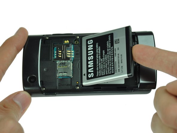

  • Use your finger to push and lift the battery towards the top of the phone.

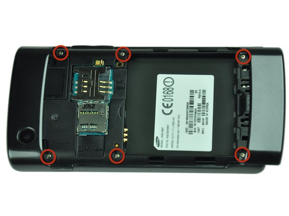

  • Remove the six 4.5mm #000 Phillips screws.

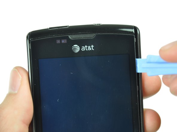

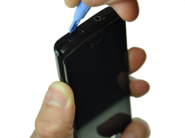

  • Starting at a bottom corner, use the spudger to separate the rear case from the front display.
  • Move your way around towards the top on both sides. The plastic opening tool is easier to use for this step.
  • Be careful when detaching the top. Free each side, stopping short of the center of the cover. Apply backward pressure on both corners with a finger applying pressure on the center, and slide the whole back cover toward the bottom of the device. Note: forcing the cover can result in cracked plastic.

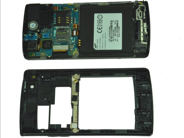

  • Separate the rear case from the phone.

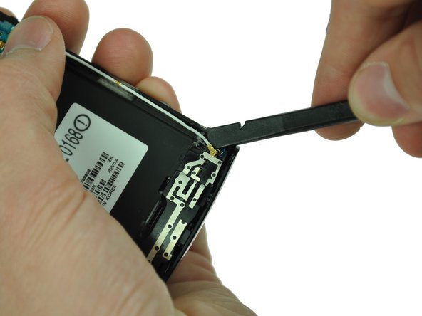

Add Note Edit Step 7 — Antenna Cable  ¶

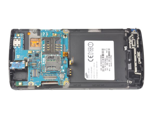

  • Use a spudger tool to pry up the antenna cable from the connector on the motherboard.
  • Pry up the other end of the cable from the connector on the antenna array.
Image #1 Image #2 Image #3

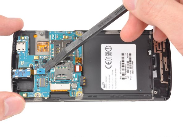

  • Remove the following ribbon cables and chips from the motherboard.
  • Use the spudger to gently pry each connection from the board.
