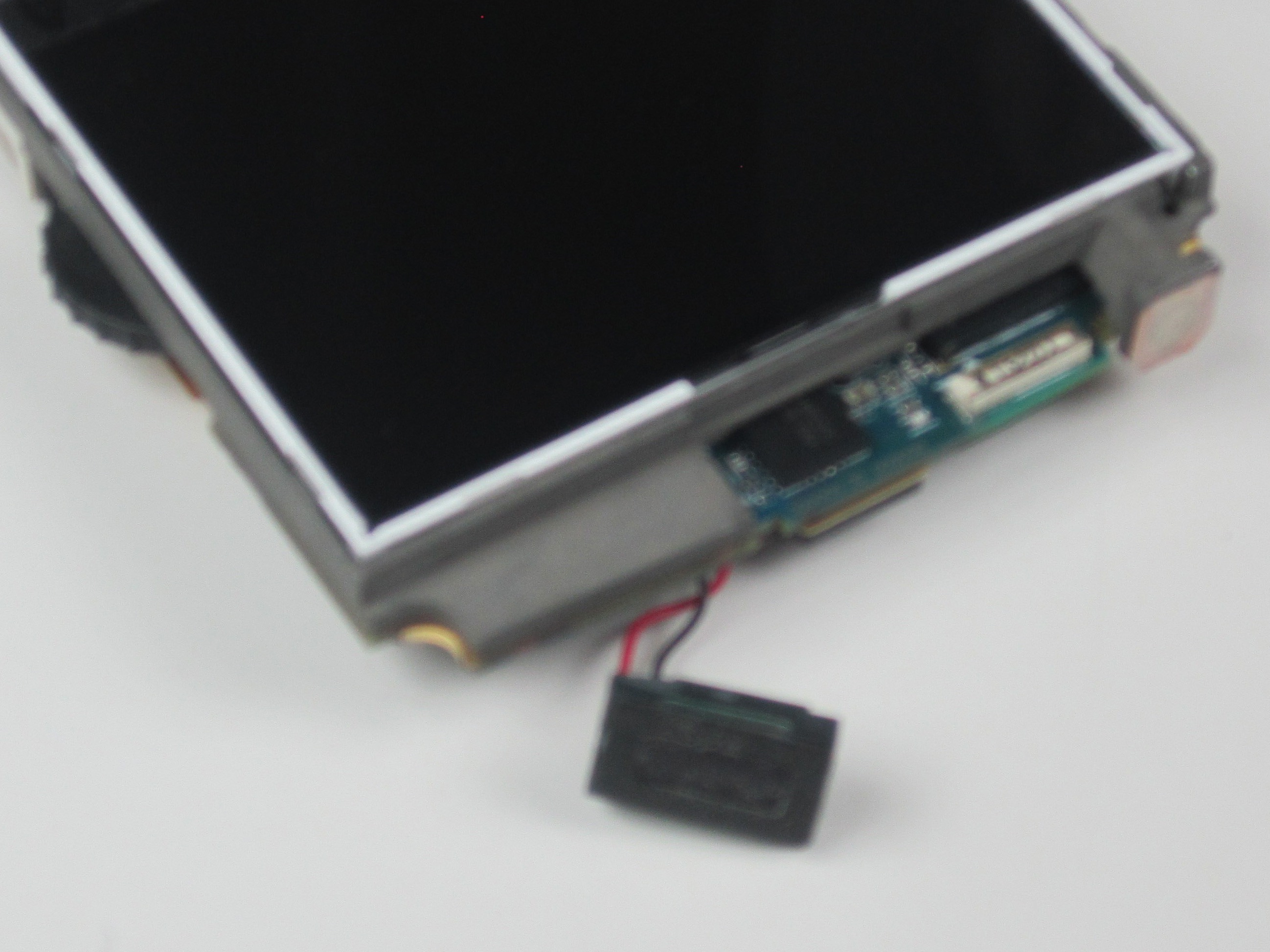

The front speaker is the speaker pressed to your ear when you are talking on the phone with someone. If the noise emitted from this speaker is distorted or if no noise is emitted at all, then installing a new speaker may help alleviate these issues.
Image #1 Image #2 Image #3

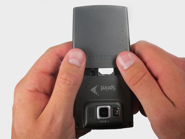

  • To remove the back casing, firmly press down and push towards the bottom of the phone.
Image #1

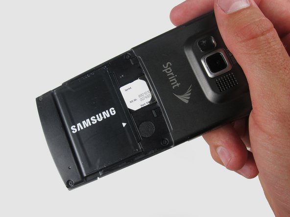

  • With the casing removed, lift the battery from the indicated indentation.
Image #1
Add Note Edit Step 3  ¶
  • From here, you can now access the SIM card and model/serial numbers.
Image #1

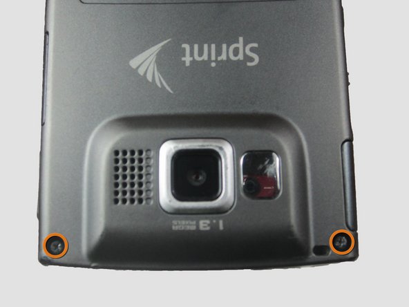

  • Using the Phillips #00 screwdriver, remove the four indicated screws (4.5 mm).
Image #1 Image #2

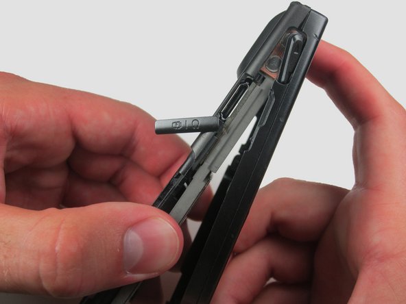

  • Press the pointed edge of the spudger into the side of the two rubber plugs in order to lift and remove them from the top of the phone.
  • Then, using the Phillips #00 screwdriver, remove the two indicated Phillip screws (6.5 mm).
Image #1

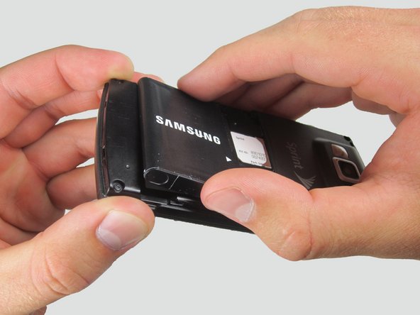

  • To remove the SIM card, start by pressing the top of the card and push down and away towards the bottom of the phone. Then, as indicated, pull the SIM card out.
Image #1 Image #2
