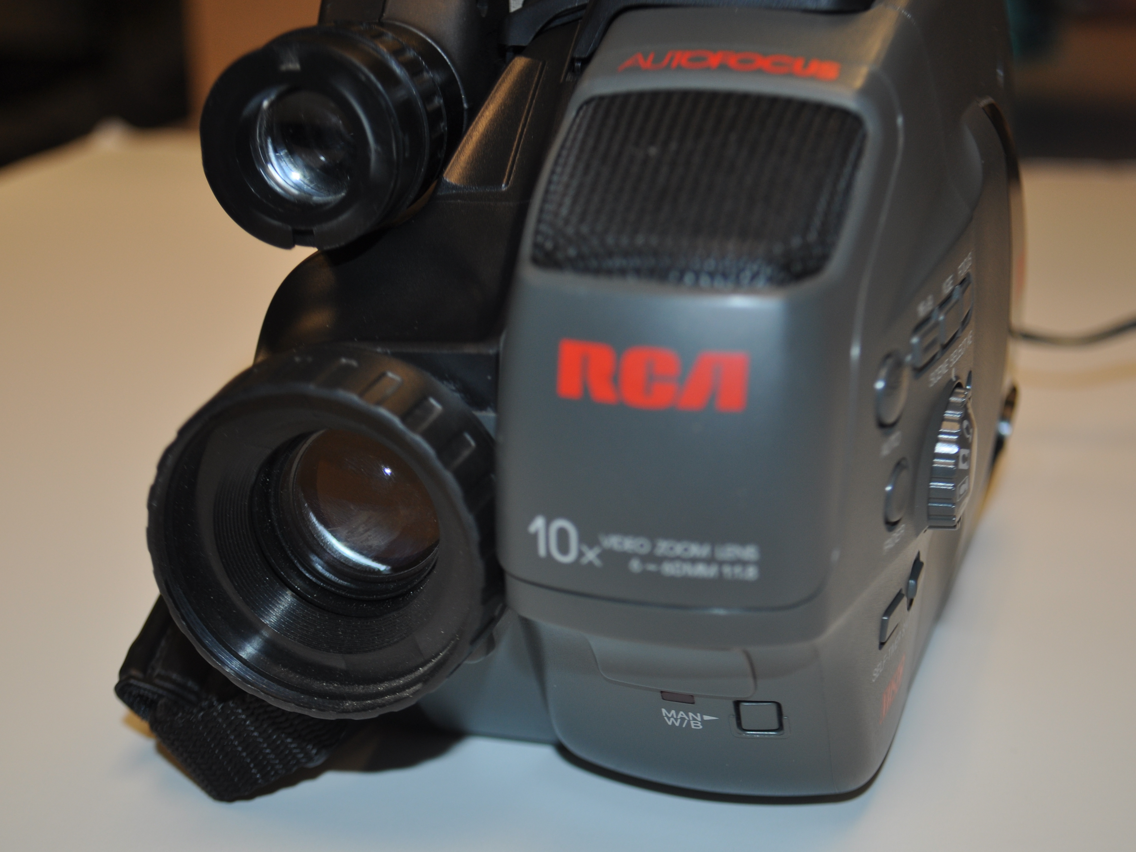

  • Inspect device, locating all screws.

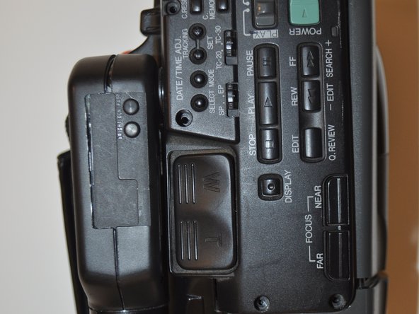

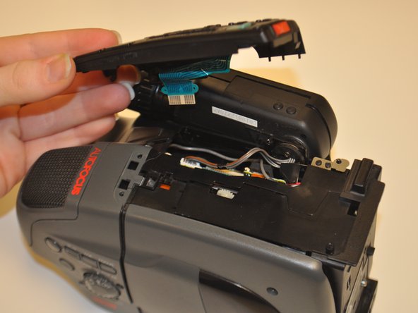

  • Remove the five (5) screws holding the top control panel (the panel containing the Play, Pause, Stop functions) in place.
  • Pry off the top control panel using the plastic wedge tool.

  • Screw off the lens cap of the large primary viewfinder along the front of the camera.

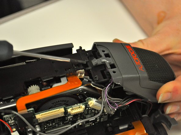

  • Pry the gray front panel away from the base of the device using the plastic wedge tool.
Image #1 Image #2

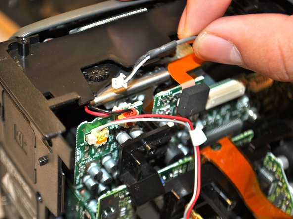

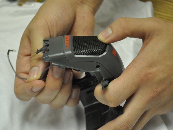

  • Pull the gray front panel away from the base of the device, exposing the speaker.
  • Disconnect the speaker from the circuit board by gently unplugging the gray cord from the connecting point on the inner component of the device.
  • Remove the speaker from the device.
