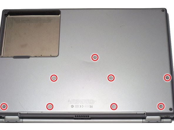

Add Note Edit Step 5 — Lower Case  ¶
  • Turn the G4 over.
  • Remove the eight T8 Torx screws from the lower case.
Image #1
Add Note Edit Step 6  ¶
  • Using your thumbs, slide the lower case away from you.
  • The lower case may stick in the front on a tab just above the center of the DVD drive. Be careful as you work the case off, or you may break the thin strip of plastic just above the drive.
  • Lift the lower case off.

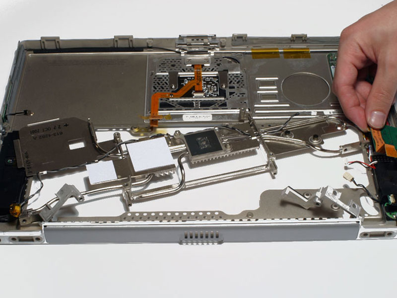

Add Note Edit Step 7  ¶
  • Your laptop should look approximately like this.
