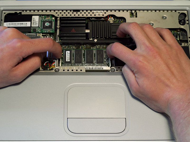

Add Note Edit Step 4 — RAM  ¶
  • Release the tabs on each side of the RAM chip at the same time. These tabs lock the chip in place and releasing them will cause the chip to "pop" up.
  • Pull the RAM chip out.
  • Repeat this process if a second RAM chip is installed.
