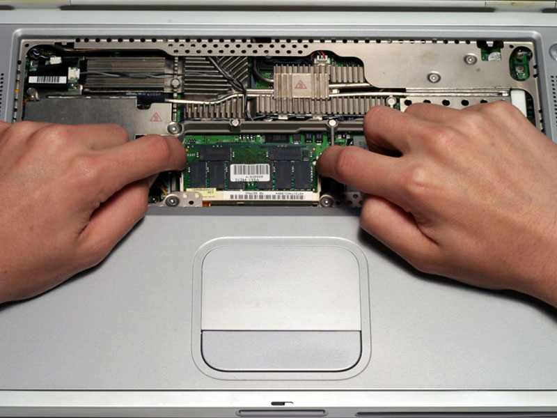

  • Locate the battery release tab on the underside of the G4.
  • Slide the battery release tab to the left and lift the battery out of the computer.
first image
Add Note Edit Step 2 — Keyboard  ¶
  • Turn the keyboard locking screw located in the middle of the keyboard so that it is parallel to the space bar. A half turn from parallel to parallel will unlock it. Another half turn will lock it again.
  • Pull the keyboard release tabs toward you and lift up on the keyboard until it pops free.
first image
Add Note Edit Step 3  ¶
  • Rest the keyboard face down on the trackpad area.
  • Disconnect the keyboard connector from the logic board.
