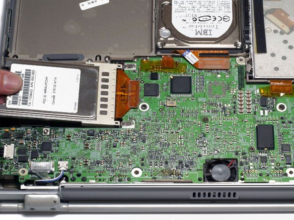

Add Note Edit Step 5 — Airport Card  ¶
  • Firmly grasp the plastic tab attached to the Airport card and pull up and to the left.
  • Disconnect the antenna cable from the left side of the Airport card.
first image

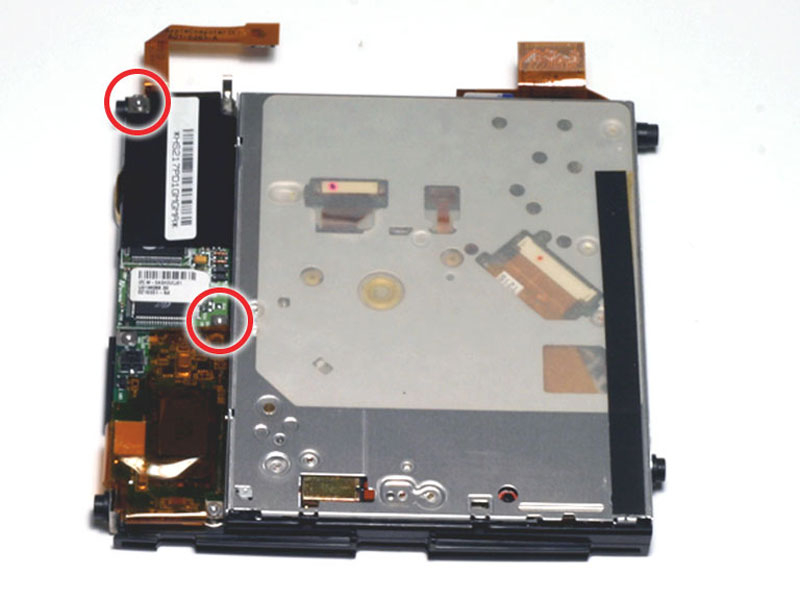

Add Note Edit Step 16 — Modem  ¶
  • Remove the two T6 Torx screws from the modem.
  • Lift the modem off the optical drive, carefully guiding the orange ribbon cable through the space in the drive mount.
