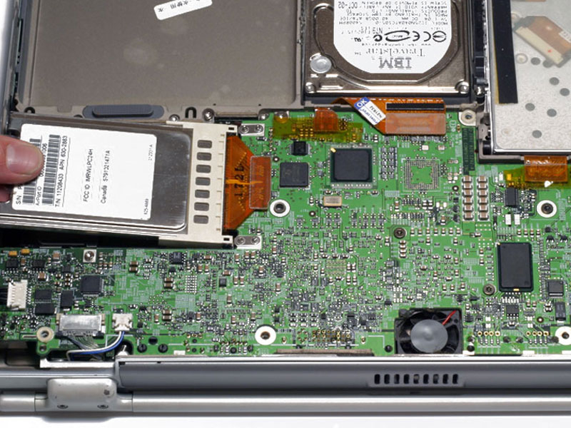

  • Locate the battery release tab on the underside of the G4.
  • Slide the battery release tab to the left and lift the battery out of the computer.
Image #1
Add Note Edit Step 2 — Lower Case  ¶
  • Remove the seven T8 Torx screws from the lower case.
Image #1
Add Note Edit Step 3  ¶
  • Using your thumbs, slide the lower case away from you.
  • The lower case may stick in the front on a tab just above the center of the optical drive. Be careful as you work the case off, or you may break the thin strip of plastic just above the drive.
  • Lift the lower case off.
Image #1
Add Note Edit Step 4  ¶
  • Your laptop should look approximately like this.
Image #1
Add Note Edit Step 5 — Airport Card  ¶
  • Firmly grasp the plastic tab attached to the Airport card and pull up and to the left.
  • Disconnect the antenna cable from the left side of the Airport card.
