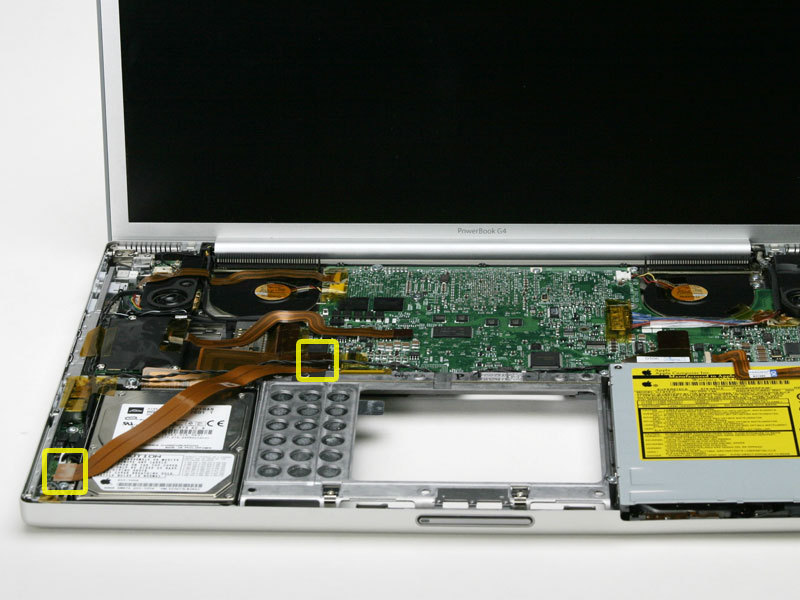

Add Note Edit Step 12 — Hard Drive  ¶
  • The sound ribbon cable is very fragile. Be especially careful when disconnecting the cable from the logic board.
  • Disconnect both ends of the orange sound ribbon cable that crosses over the hard drive, removing tape as necessary.
first image
