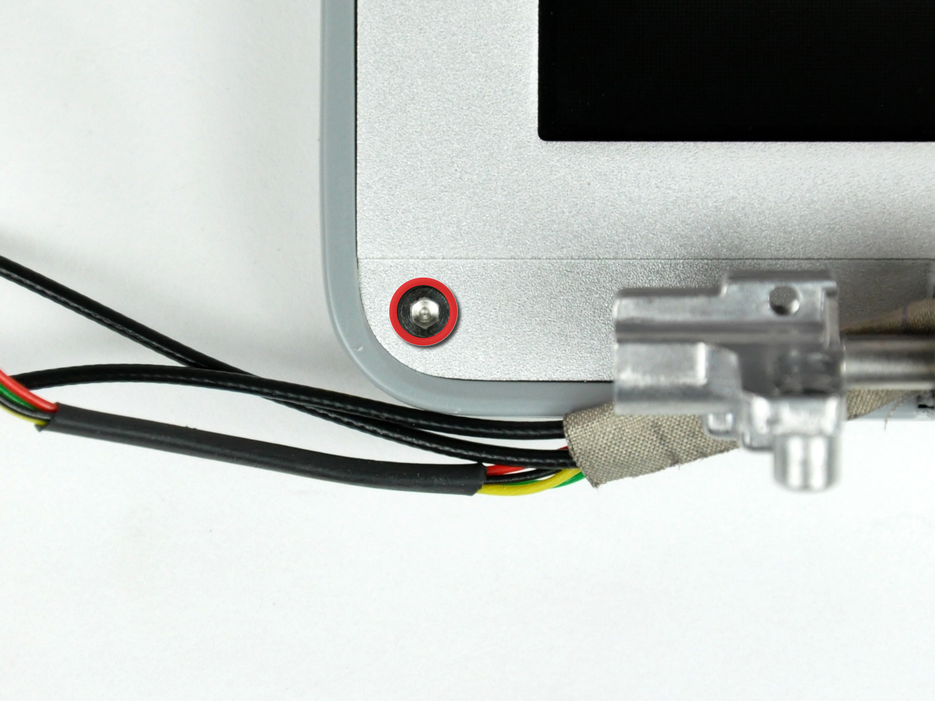

Add Note Edit Step 1 — Rear Display Bezel  ¶

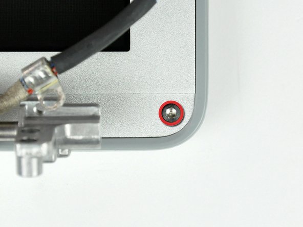

  • Remove the two 6mm long, 1.5 mm hex screws near the lower left and right corners of the display.
  • A T6 Torx screwdriver works just fine.

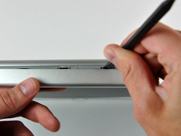

Add Note Edit Step 2  ¶

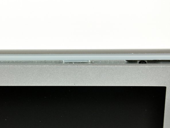

  • Insert the flat end of a spudger between the front display bezel and the plastic rim attached to the rear bezel near the lower left corner of the display.
  • Do not insert the spudger between the plastic rim of the rear display bezel and the aluminum rear display bezel plate.

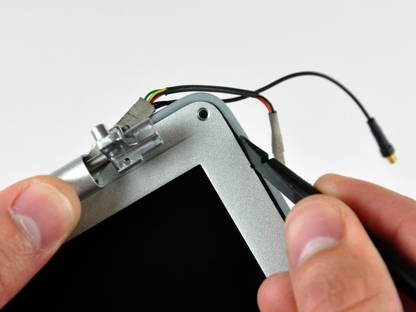

Add Note Edit Step 3  ¶

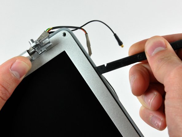

  • With your spudger still inserted under the front display bezel, run it around the lower left corner of the display.
  • Rotate the spudger away from yourself to pry the rear display bezel off the aluminum tabs on the front display bezel.
  • Work your way down the side of the display until the rear display bezel has been separated from the front display bezel.

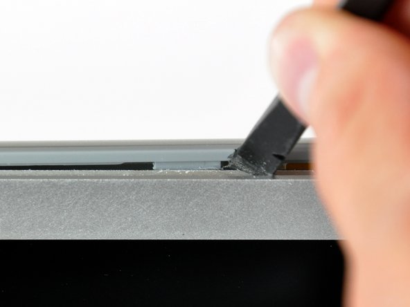

  • Insert the flat end of a spudger between the rear display bezel and the clutch cover.
  • Twist the spudger to unclip the rear bezel from the clutch cover.

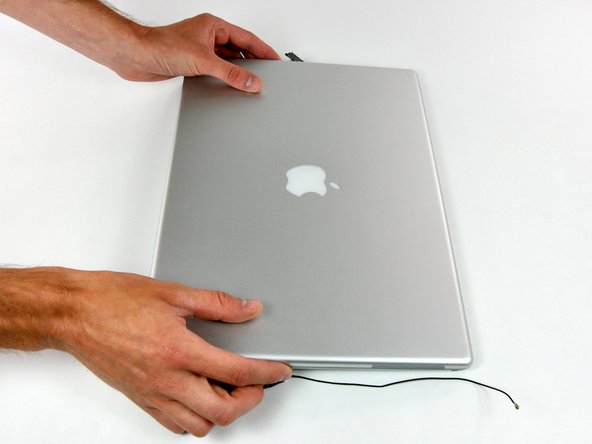

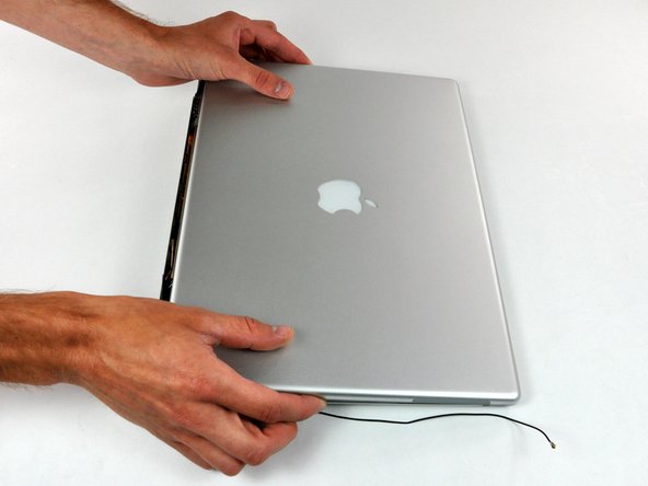

Add Note Edit Step 6  ¶

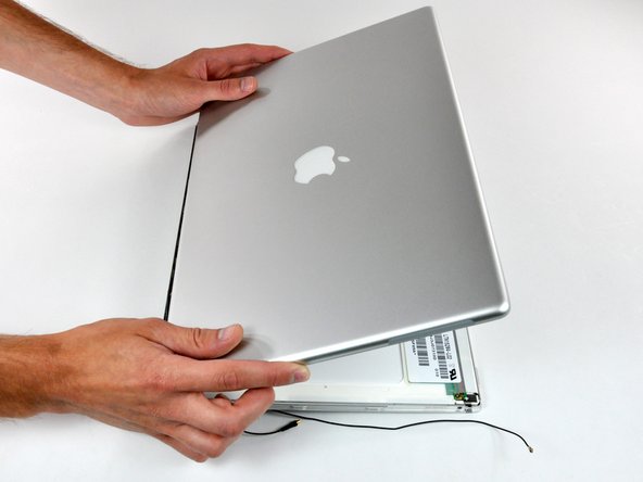

  • Slightly lift the lower edge of the rear display bezel and push it toward the top edge of the display, releasing the clips along the top edge of the rear display bezel.
  • Rotate the rear display bezel toward yourself and lay it flat on the table.

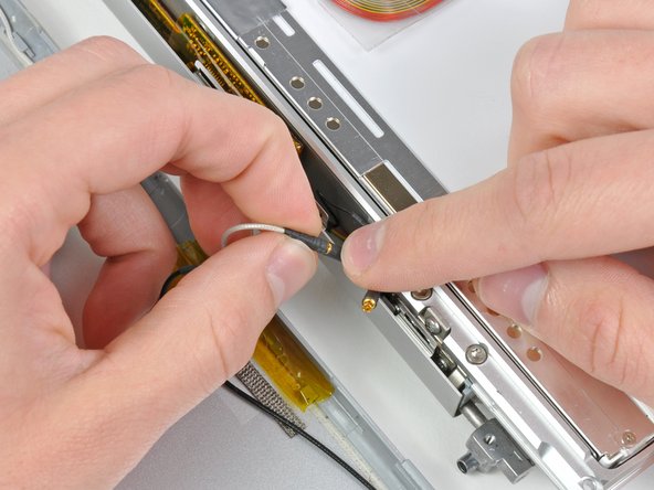

Add Note Edit Step 7  ¶
  • Disconnect both antenna cables from the rear display bezel.
  • Remove the rear display bezel and set it aside.
