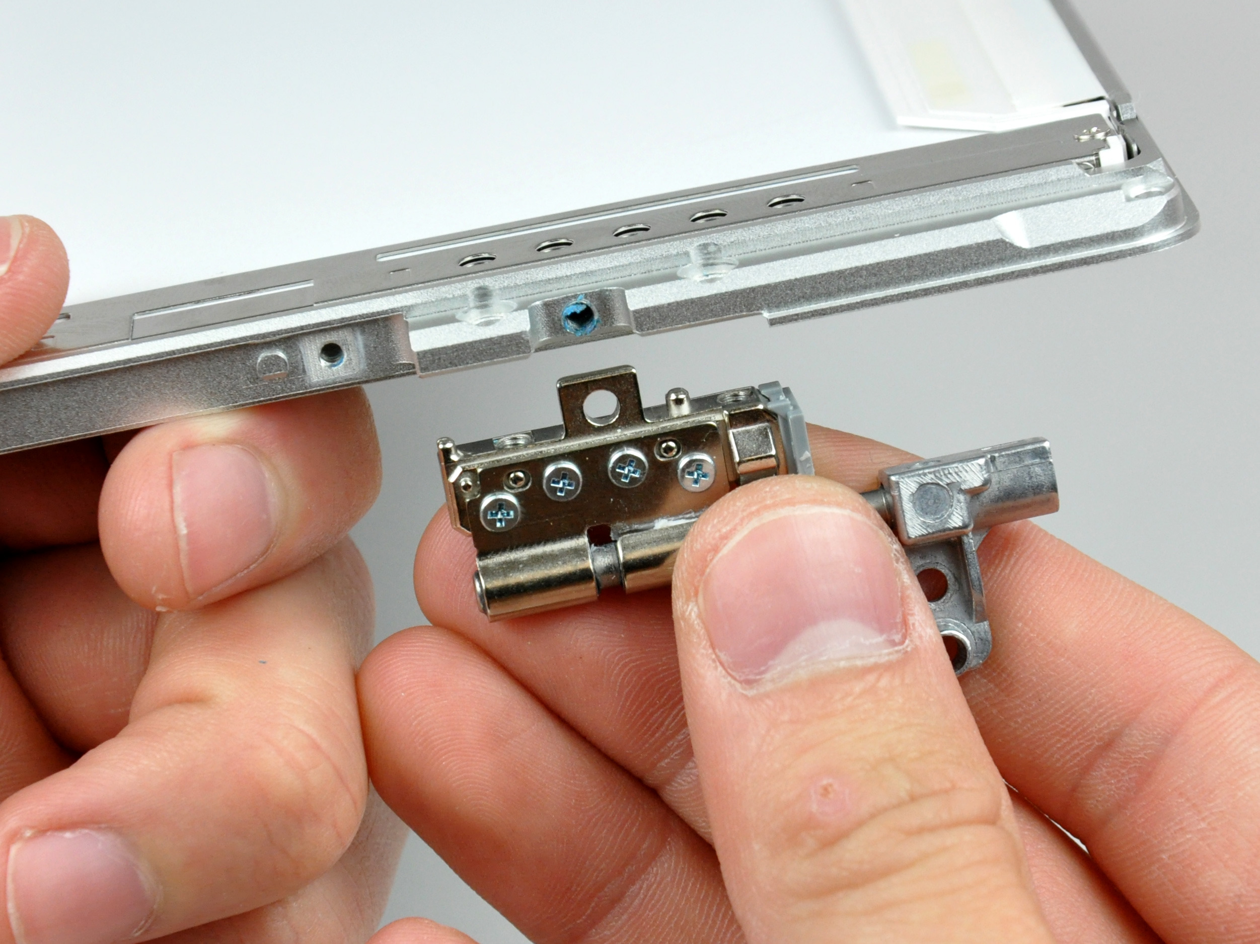

Add Note Edit Step 33 — Left Clutch Hinge  ¶
  • Remove the three 5.7 mm T8 Torx screws securing the left clutch hinge to the front bezel.
first image
Add Note Edit Step 34  ¶
  • Remove the left clutch hinge from the front bezel.
