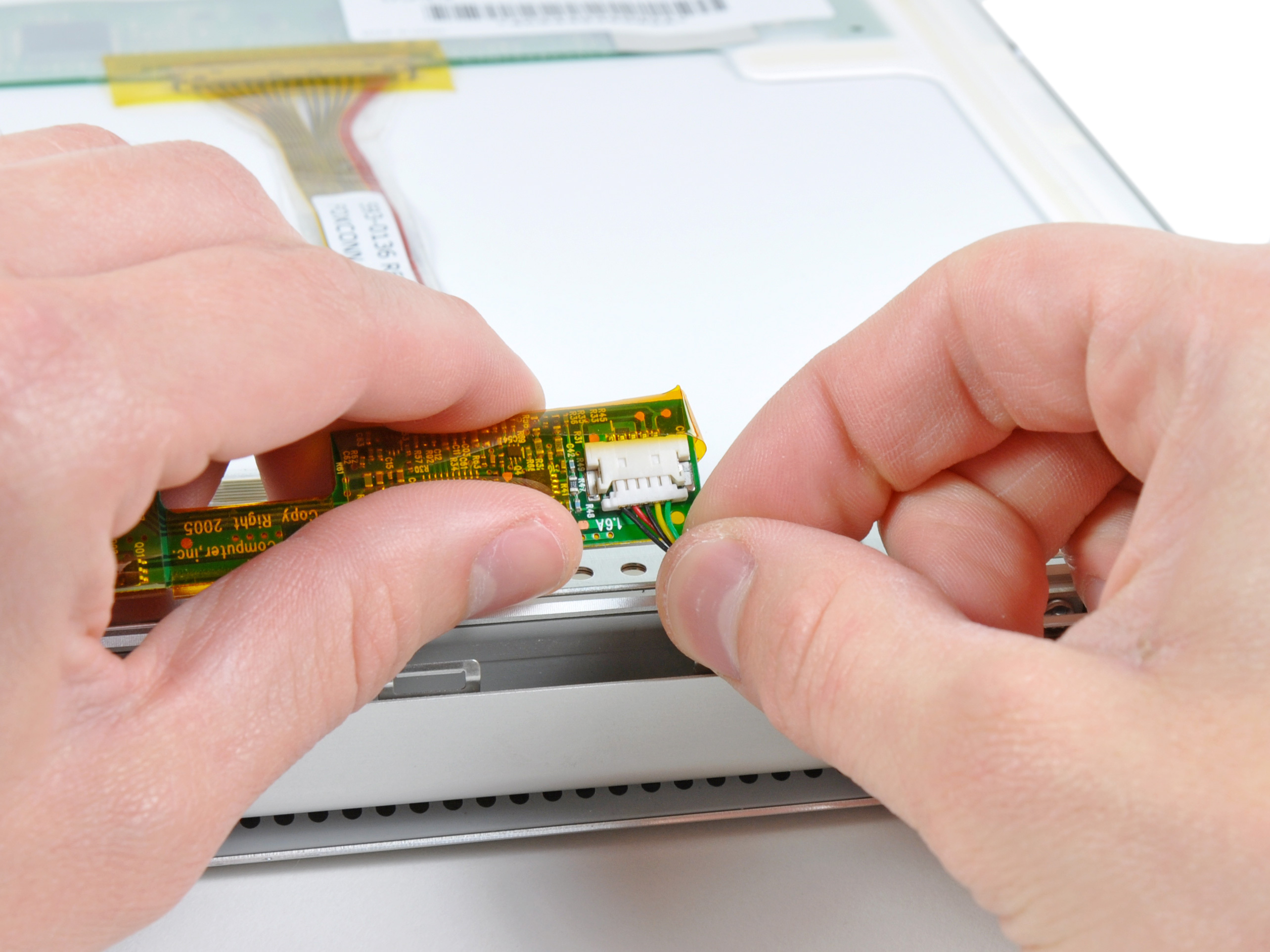

Add Note Edit Step 13  ¶
  • The inverter is an extremely thin circuit board that is very delicate and easily cracked. Take care when handling.
  • Using the tip of a spudger, raise the inverter out from the clutch cover.
  • Lift the inverter enough to reveal both cable connectors.
first image
thumb image 1
thumb image 2
Add Note Edit Step 14  ¶
  • Disconnect both inverter cables by pulling their connectors away from the sockets on the inverter board.
  • Remove the inverter from the display.
