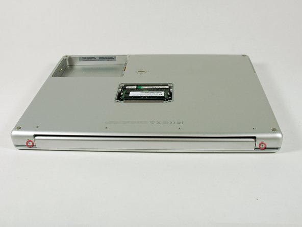

  • Turn the computer 90 degrees clockwise so the hinge faces you.
  • Remove the lower 5 mm Phillips screw on each side of the hinge (two total).

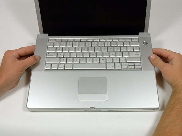

Add Note Edit Step 8  ¶
  • Grasp the back corners of the upper case and pull up.
    • Do not pull the upper case off yet; you still need to disconnect the keyboard and trackpad cable.
  • Lift the back of the case up and work your fingers along the sides, freeing the case as you go. Once you have freed the sides, you may need to rock the case up and down to free the front of the upper case.
