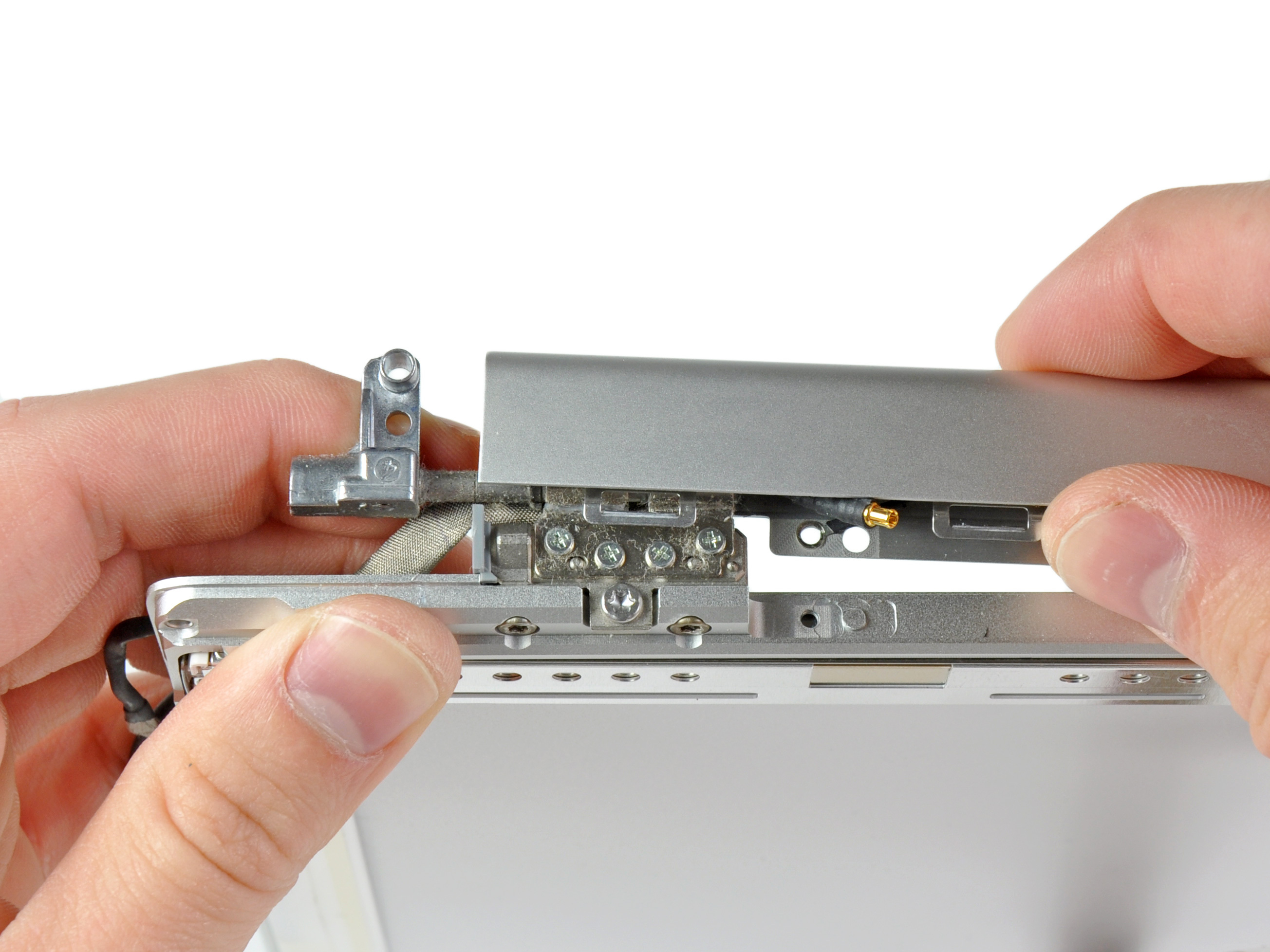

Add Note Edit Step 27 — Clutch Cover  ¶
  • The inverter is an extremely thin circuit board that is very delicate and easily cracked. Take care when handling.
  • Use a spudger to raise the end of the inverter out from the clutch cover.
  • Lift the inverter enough to access both cable connectors.
first image
thumb image 1
thumb image 2
Add Note Edit Step 28  ¶
  • Disconnect both inverter cables by pulling their connectors away from the sockets on the inverter.
  • Remove the inverter from your display and set it aside.
first image
Add Note Edit Step 29  ¶
  • Remove the five 2 mm Phillips screws securing the LCD retaining bracket to the front display bezel.
  • Lift the LCD retaining bracket off the front display bezel.
  • Some machines do not have this bracket. If your machine is missing the bracket, remove the five screws and proceed to the next step.
first image
thumb image 1
thumb image 2
Add Note Edit Step 30  ¶
  • The clutch cover is constructed from aluminum and is held on to the clutch hinges with metal clips that require a good deal of force to remove. Proceed with caution.
  • Use your thumbs to push the clutch cover away from the clutch hinges.
  • While pressing with your thumbs, rotate the clutch cover toward yourself about its long edge to pop it off the clutch hinge.
  • It may be necessary to wiggle the clutch cover while pressing it away from the clutch hinges to release the retaining clips.
first image
Add Note Edit Step 31  ¶
  • Repeat this process for the other side of the clutch cover. Once the clutch cover is completely free from the clutch hinges, lift it off the front display bezel.
