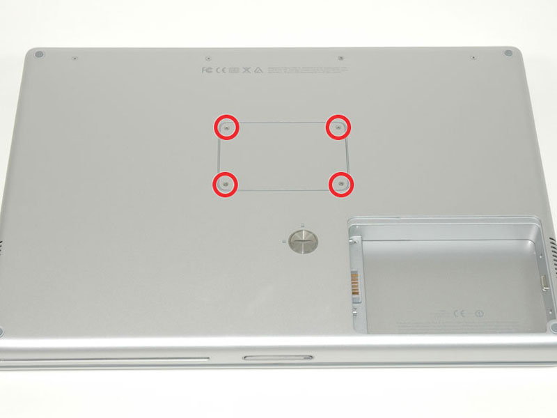

  • Use a coin to turn the battery locking screw 90 degrees clockwise.
Image #1
Add Note Edit Step 2 — Upper Case  ¶
  • Remove the four Phillips screws from the memory door.
  • Slide the memory door away from the memory compartment.
Image #1
Add Note Edit Step 3  ¶
  • Remove the following 8 screws:
    • Two 3 mm Phillips in the battery compartment, on either side of the battery contacts.
    • Two 12 mm Phillips on either side of the memory compartment.
    • Four 16 mm Phillips along the hinge.
Image #1
Add Note Edit Step 4  ¶
  • Rotate the computer 90 degrees clockwise, so that the power receptacle faces you.
  • Remove the three 3 mm Phillips screws.
  • When replacing these screws, you must place each screw in the correct order. Begin by installing the screw closest to the display hinge, and go out from there.
Image #1
Add Note Edit Step 5  ¶
  • Turn the computer 90 degrees clockwise so that the hinge faces you.
  • Remove the bottom 5 mm Phillips screw on either side of the hinge (two total).
Image #1
Add Note Edit Step 6  ¶
  • Rotate the computer 90 degrees clockwise, so that the ports face you.
Image #1
Add Note Edit Step 7  ¶
  • Turn the computer over and open the display.
  • Remove the two 1.5 mm hex screws in either corner, next to the display (a T6 Torx driver will work, but repeated use will strip the screws).
Image #1
Add Note Edit Step 8  ¶
  • Grasp the back corners of the upper case and pull up. Do not pull the upper case off yet; you still need to disconnect the keyboard and trackpad cable.
  • Lift the back of the case up and work your fingers along the sides, freeing the case as you go. Once you have freed the sides, you may need to rock the case up and down to free the front of the upper case.
