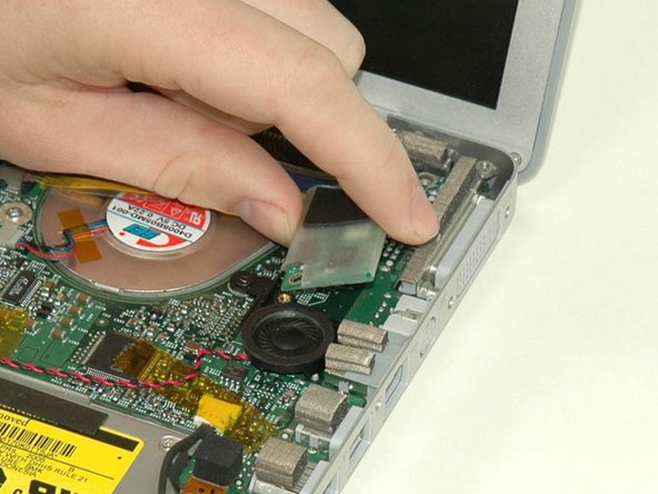

  • Rotate the upper case up and toward the screen, so that the upper case rests against it.
Image #1
Add Note Edit Step 10  ¶
  • Remove the orange tape securing the trackpad ribbon to the logic board.
  • Disconnect the trackpad ribbon from the logic board.
  • Remove the upper case from the computer.

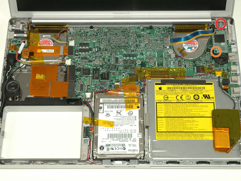

Add Note Edit Step 11 — Right Ambient Light Sensor  ¶
    • Remove the 9.5 mm silver Phillips screw from the top of the right ambient light sensor board.
    • Remove the small 3 mm black Phillips screw from the bottom of the board.

Add Note Edit Step 12  ¶
  • Lift the right ambient light sensor board from the computer.
