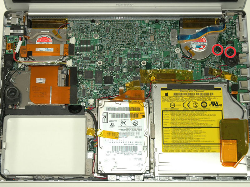

Add Note Edit Step 13 — Logic Board  ¶
  • Remove the two black Phillips screws from the right speaker.
  • Lift the speaker away from the logic board and place it aside
first image
