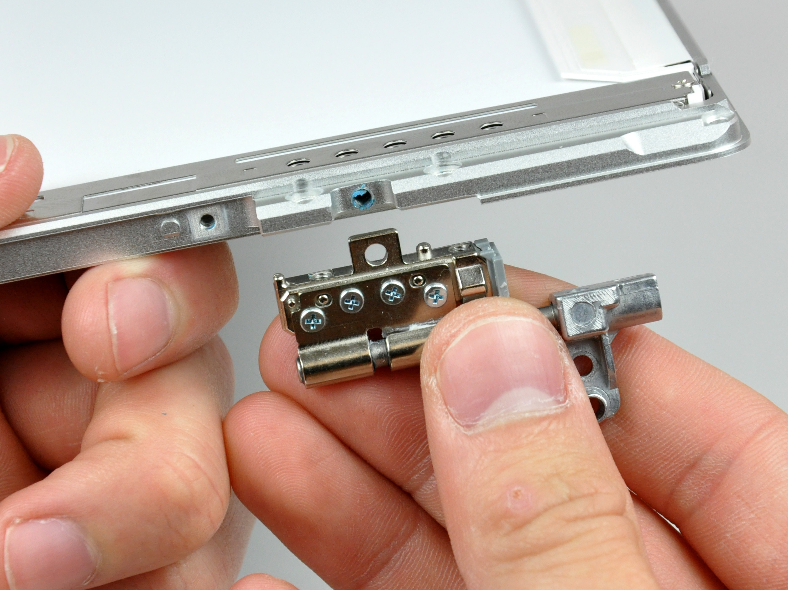

Add Note Edit Step 38 — Rear Display Bezel  ¶
  • Remove the two 11 mm X 1.5 mm hex screws near the lower left and right corners of the display.
  • A T6 Torx screwdriver works just fine.
Image #1
Add Note Edit Step 39  ¶
  • Insert the flat end of a spudger between the front display bezel and the plastic rim attached to the rear bezel near the lower left corner of the display.
  • Do not insert the spudger between the plastic rim of the rear display bezel and the aluminum rear display bezel plate.
Image #1 Image #2
Add Note Edit Step 40  ¶
  • With your spudger still inserted under the front display bezel, run it around the lower left corner of the display.
  • Rotate the spudger away from yourself to pry the rear display bezel off the aluminum tabs on the front display bezel.
  • Work your way down the side of the display until the rear display bezel has been separated from the front display bezel.
