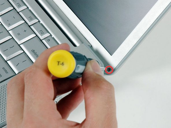

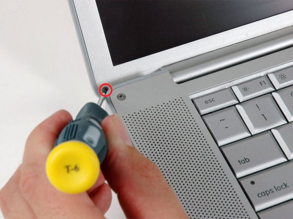

  • Open the computer with the display facing you and rotate the display back as far as possible.
  • Remove the T6 Torx screw from the bottom left corner of the display assembly. The computer casing will not allow the screwdriver to be inserted directly into the screw, so be careful not to strip the screw.
first image

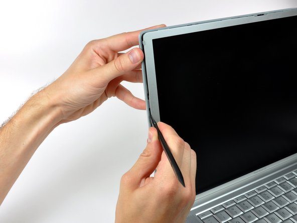

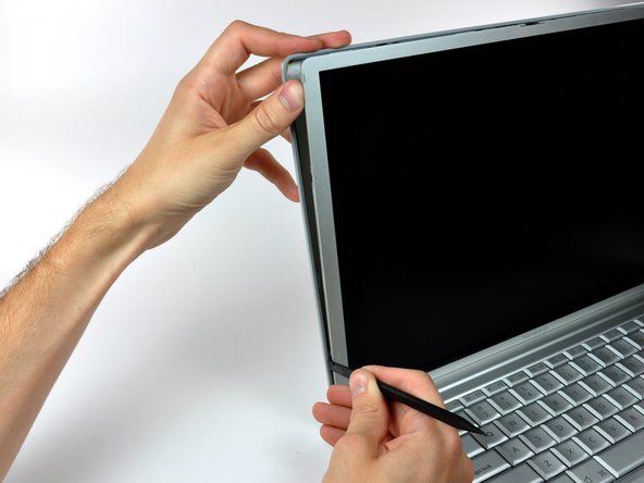

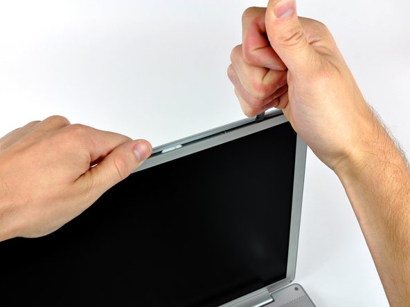

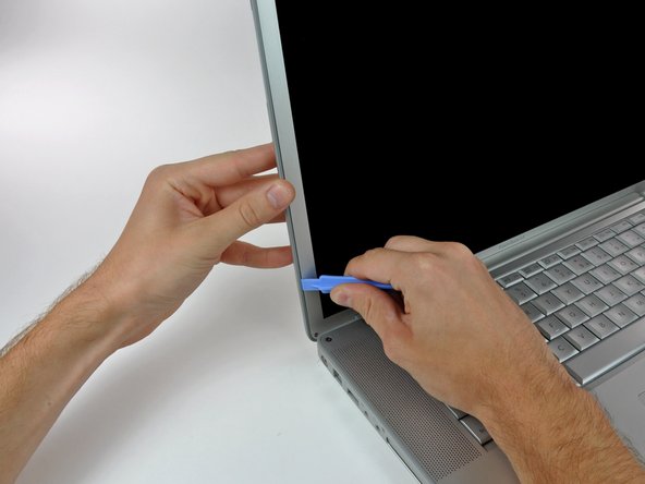

  • The next few steps require the use of plastic opening tools and spudgers that will probably be destroyed in the process. Have a few spares of each tool handy.

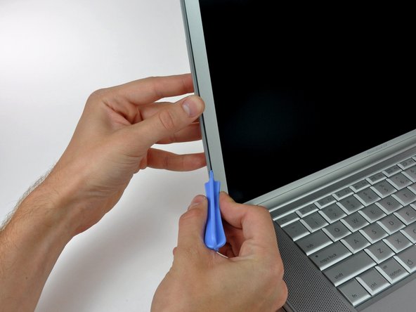

  • Insert a plastic opening tool between the left edge of the front display bezel and the plastic strip attached to the rear bezel, with the edge of the tool angled toward the LCD.
  • Rotate the tool away from the LCD to pop the rear bezel off the tabs on the front display bezel.
  • Work along the left edge of the display until the rear bezel is evenly separated from the front bezel.
  • Freeing these tabs may require some force. Be sure to support the display assembly with your other hand to avoid putting too much strain on the hinges.

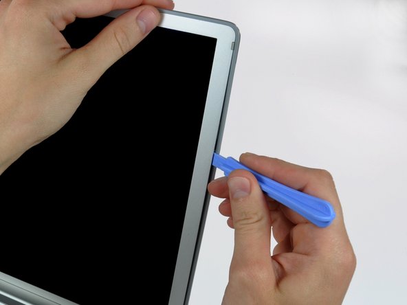

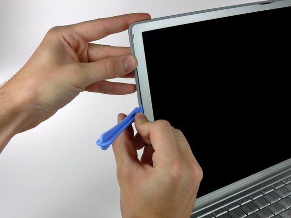

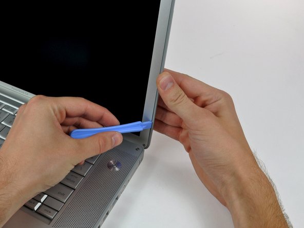

Add Note Edit Step 5  ¶
  • Insert a plastic opening tool between the right edge of the front display bezel and the plastic strip attached to the rear bezel, with the edge of the tool angled toward the LCD.
  • Work along the right edge of the display until the rear bezel is evenly separated from the front bezel.

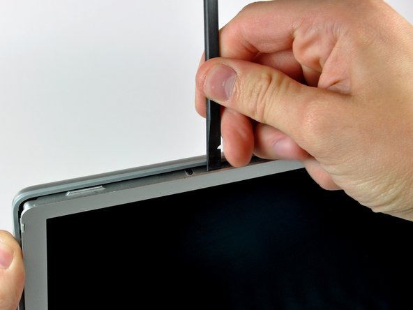

Add Note Edit Step 6  ¶

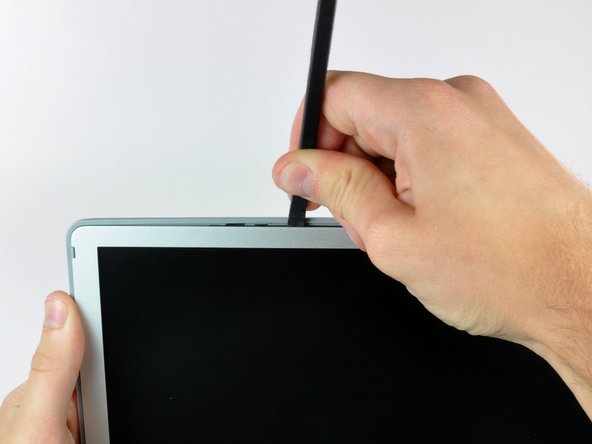

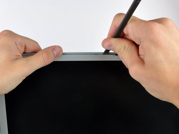

  • Insert a spudger just to the left of the hinge opening on the top edge of the display between the front display bezel and the plastic strip attached to the rear bezel.
  • Pry the rear bezel away from the front bezel along the top left half of the display.
  • If the flat end of your spudger is flexing too much, trim about .125" of the end to increase its stiffness.

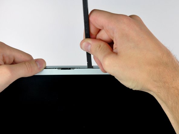

  • Insert a spudger just to the right of the hinge opening on the top edge of the display between the front display bezel and the plastic strip attached to the rear bezel.
  • Pry the rear bezel away from the front bezel along the top right half of the display.
  • To release the clips in the far left and right corners of the display, it may be necessary to run a spudger parallel to the face of the display along the top edge of the front display bezel and force it into the corners to pop the rear bezel off.

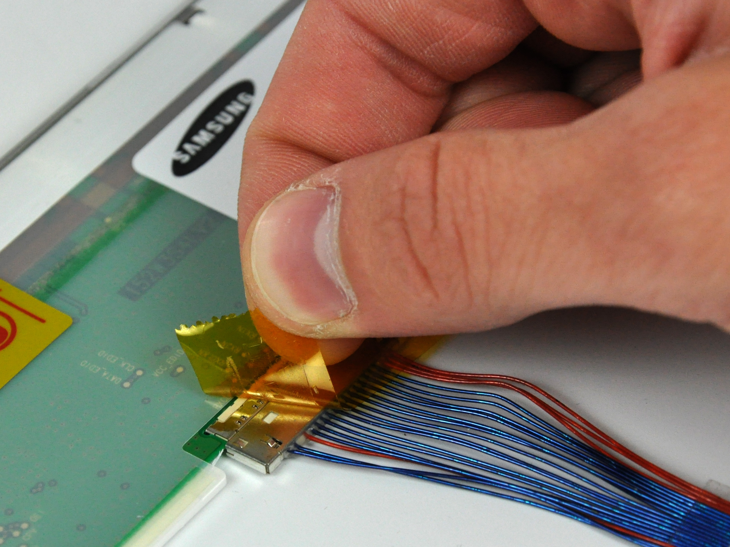

  • If necessary, remove the piece of tape covering the display data cable connector.
  • Pull the display data cable connector away from its socket to disconnect it from the LCD.
