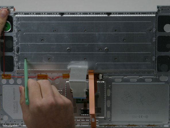

  • Place the upper casing on edge and use a spudger to push the keyboard away from the casing, poking the spudger through the holes where the screws were.
first image

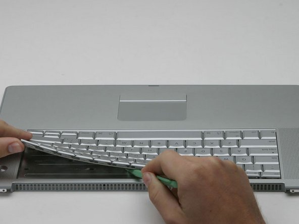

Add Note Edit Step 20  ¶
  • Lay the casing flat so that the keyboard faces up and and slowly pry the keyboard up, beginning at the back edge along the 'F' keys, and moving toward the space bar.
first image
Add Note Edit Step 21  ¶
  • Pull the freed keyboard directly up, minding the cable as it slides through the slot in the casing (watch out for the adhesive on the underside of the case).
