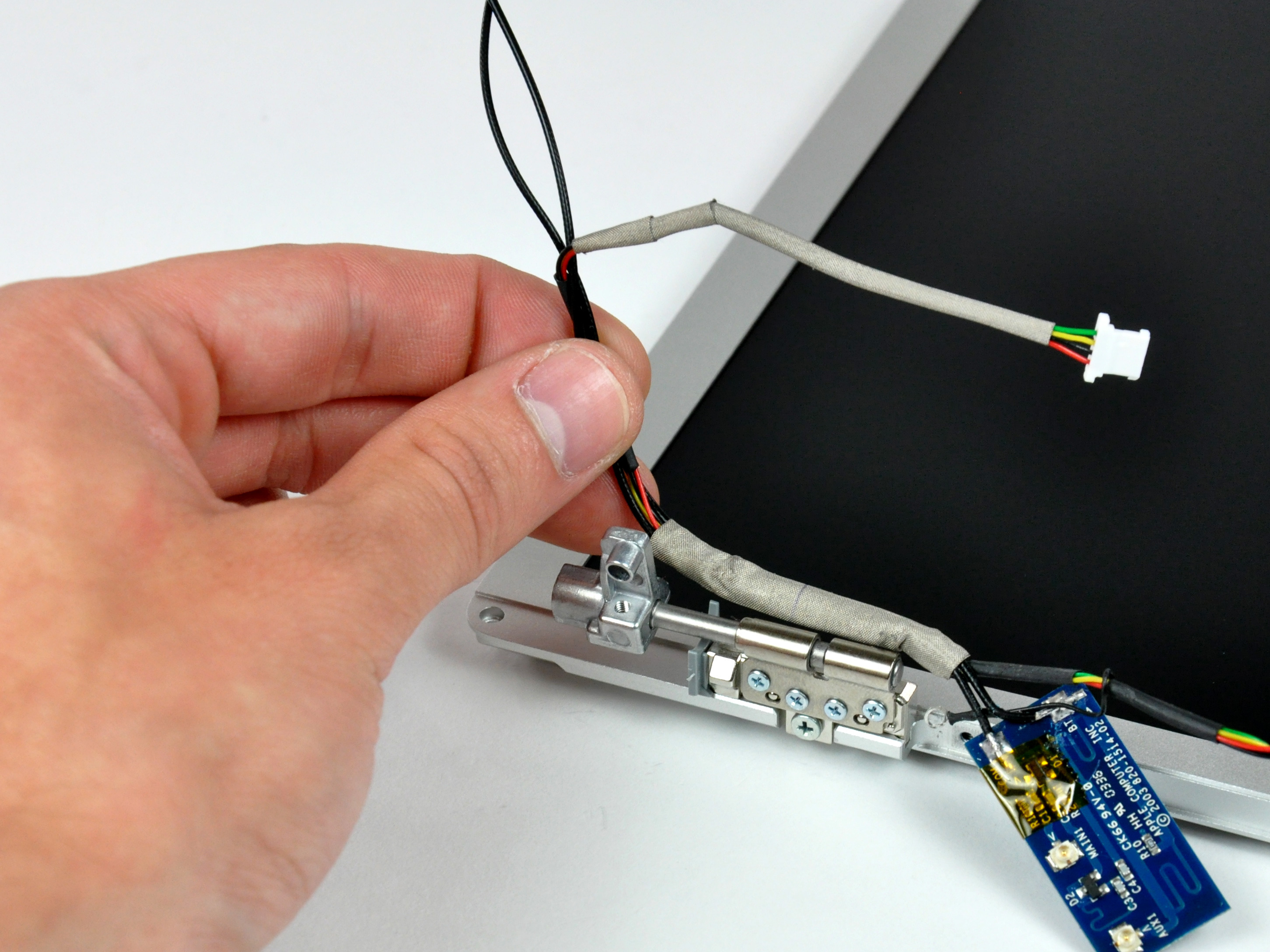

Add Note Edit Step 40 — Inverter/Antenna Cables  ¶
  • De-route the inverter/antenna cables from the left clutch hinge and lift them out of your display.
