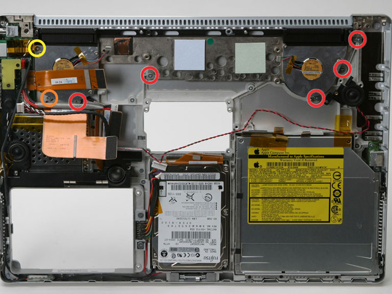

  • Rotate the upper case up and toward the screen, so that the upper case rests against it.
Image #1
Add Note Edit Step 12  ¶
  • Remove the orange tape securing the trackpad ribbon to the logic board.
  • Disconnect the trackpad ribbon from the logic board.
Image #1
Add Note Edit Step 13  ¶
  • This is a diagram of the keyboard ribbon clamp connector you will disconnect in the next step.
  • 1) With your fingernails, grasp the locking bar on either side and pull up a small amount (about 1/16" or 2 mm).
  • 2) After disengaging the locking bar, slide the cable out of the connector.
Image #1
Add Note Edit Step 14  ¶
  • Loosen the keyboard ribbon clamp by pushing the thin black piece toward the screen, using the tips of your fingers.
  • The black piece is very fragile and easily broken. Use care when separating it from the main socket.
  • Slide the grey keyboard ribbon out of the loosened connector.
  • Remove the upper case from the computer.
Image #1
Add Note Edit Step 15 — Display  ¶
  • If you have already removed the hard drive or optical drive, your computer may differ slightly from the images in this section. These parts do not affect this procedure.
  • Close the display and turn the hinge side of the computer to face you.
  • Remove the remaining Phillips screw on either side of the hinge (two screws total).
Image #1
Add Note Edit Step 16  ¶
  • Open the computer with the display facing you.
  • Use a spudger to pry the bluetooth board from the gap between the battery housing and front of the lower case.
