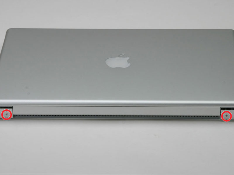

Image #1
Add Note Edit Step 23  ¶
  • Be sure to support the display with one hand while removing the final two screws.
  • Remove the longer T8 Torx screw remaining on either hinge (two screws total).
Image #1
Add Note Edit Step 24  ¶
  • Lift the display off.
