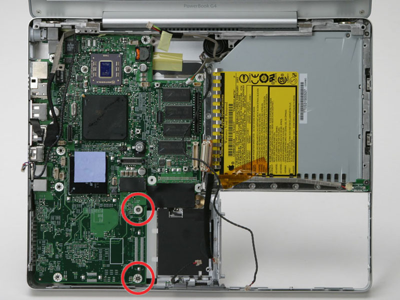

Add Note Edit Step 23 — Hard Drive  ¶
  • Remove the two Phillips screws from the hard drive bracket.
Image #1
Add Note Edit Step 24  ¶
  • Use the orange plastic loop to disconnect the hard drive cable from the logic board.
