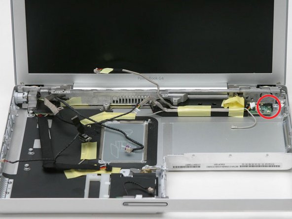

Image #1
Add Note Edit Step 57  ¶
  • Remove the single Phillips screw from the right side of the board.
  • Lift the bluetooth board out of the computer.

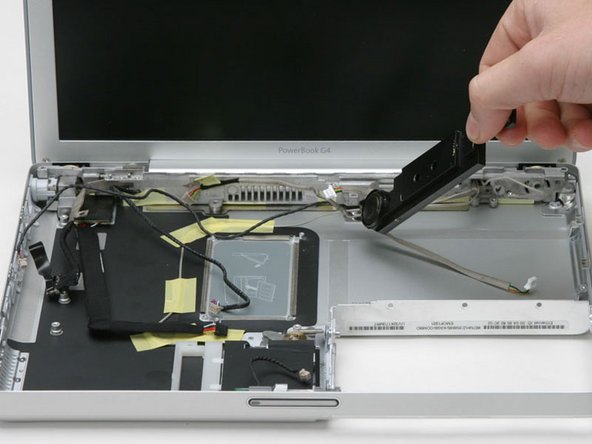

Add Note Edit Step 58 — Subwoofer  ¶
  • Peel back the yellow tape from the right side of the subwoofer.
  • Remove the single Phillips screw from the right side of the subwoofer, under the tape you just removed.
  • Remove the yellow tape that secures the remaining cables to the side of the subwoofer.
Image #1
Add Note Edit Step 59  ¶
  • Slide the subwoofer away from the screen and out of the computer.

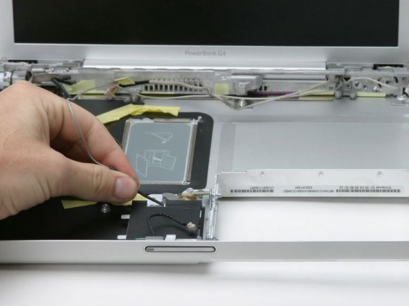

Add Note Edit Step 60 — Display  ¶
  • Deroute the Airport Extreme antenna from the card slot and lower case, removing tape as necessary.

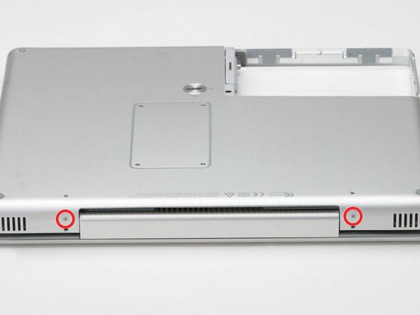

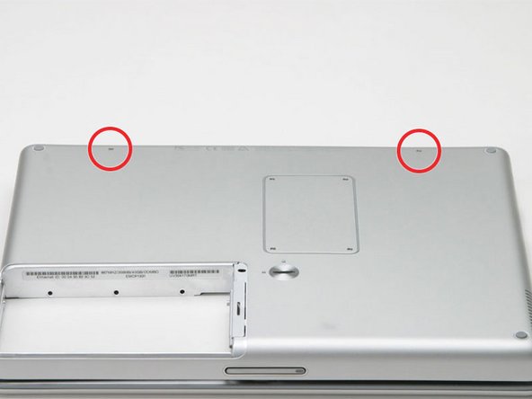

Add Note Edit Step 61  ¶
  • Place a cloth between the screen and the bottom case.
  • Close the bottom case and turn the laptop over.
  • Remove the two Phillips screws from the bottom case.

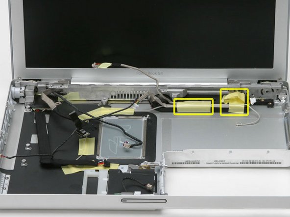

Image #1
Add Note Edit Step 62  ¶
  • Remove the two Phillips screws from either side of the display hinge.
Image #1
Add Note Edit Step 63  ¶
  • Grasp the lower case and push down on the hinge side while rotating the other end of the case toward you until it pops free, then remove it entirely (leaving the display).
  • You have effectively removed the computer from the display.
