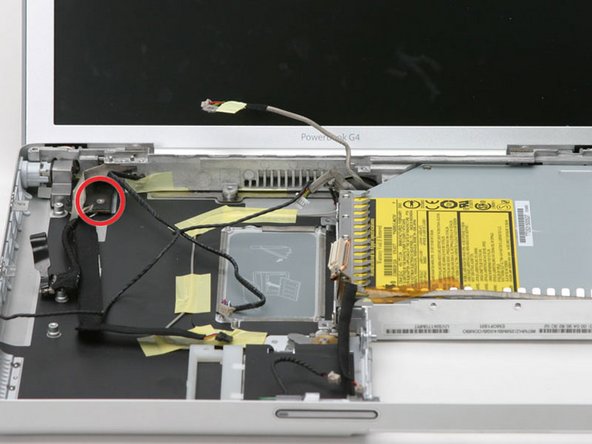

Image #1
Add Note Edit Step 49 — DC-In Board  ¶
  • There may be black tape covering the screw in the following step, remove it if necessary.
  • Remove the single Phillips screw that attaches the DC-In board to the lower case.
Image #1

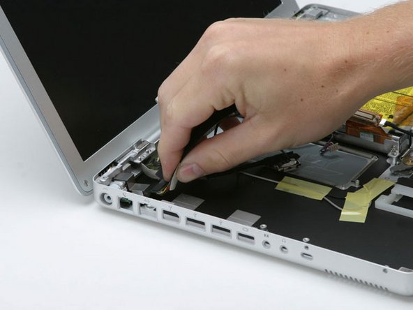

Add Note Edit Step 50  ¶
  • Pull the flat, black DC power cable up from the bottom of the case, removing tape as necessary.
  • Lift up the front right corner of the DC-In board and rotate it clockwise to slide the power receptacle out of the lower case.
No image
Add Note Edit Step 51  ¶
  • The tip of my power supply plug broke off inside the power receptacle.
  • Once the DC-in board has been removed.
  • Peal back the metal RFI shield.
  • At the back of the power receptacle - gently pull the top of the center tab out away from the receptacle body. Forming a gap.
  • From the front of the receptacle - use a screwdriver to push the broken tip out the gap.
  • Push the center tab back in place.
  • Replace the RFI shield.
Image #1

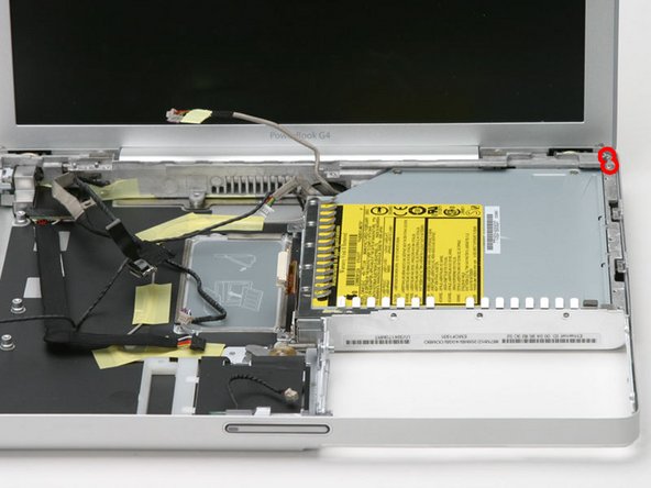

Add Note Edit Step 52 — Optical Drive  ¶
  • Remove the two Phillips screws from the upper right corner of the computer.
  • Remove the newly-liberated small metal bracket.

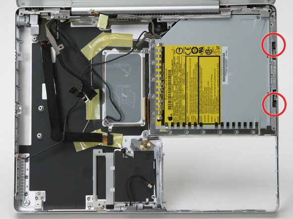

Image #1
Add Note Edit Step 53  ¶
  • Remove the two recessed Phillips screws on the right side of the optical drive.
Image #1

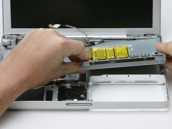

Add Note Edit Step 54  ¶
  • Lift the optical drive up by its front left corner and pull it out of the computer.
  • If you have a CD or any other object jammed in your optical drive, we have an optical drive repair guide.
Image #1

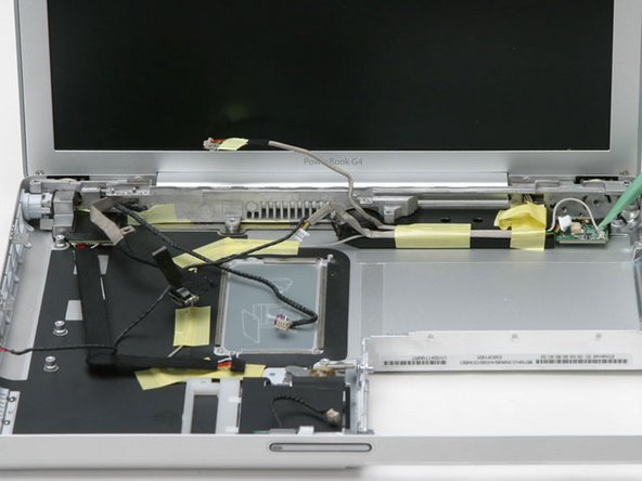

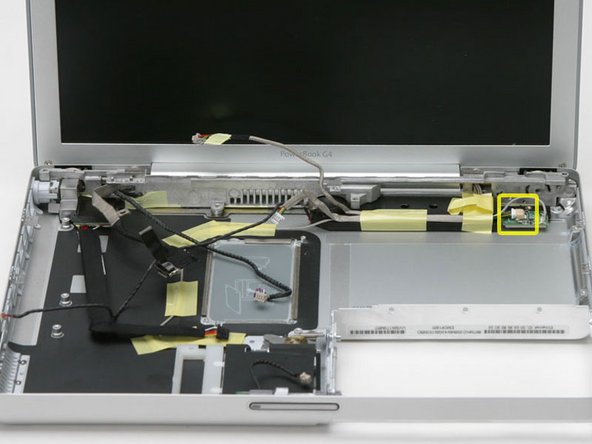

Add Note Edit Step 55 — Bluetooth  ¶
  • Disconnect the multicolor connector by sliding it to the left.
Image #1
Add Note Edit Step 56  ¶
  • Disconnect the silver bluetooth cable by pulling directly up.
