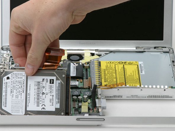

Add Note Edit Step 25  ¶
  • Use the orange cable to pull the hard drive up, then pull it and the hard drive bracket out of the computer.

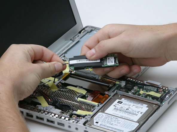

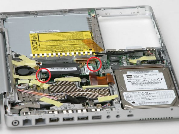

Add Note Edit Step 26 — Modem  ¶
  • Remove the two Phillips screws from the corners of the modem.
Image #1

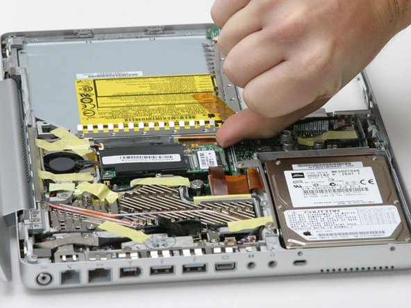

Add Note Edit Step 27  ¶
  • Pry the modem up from the trackpad side.
Image #1
Add Note Edit Step 28  ¶
  • Disconnect the modem cable from the modem.

Add Note Edit Step 29 — Heat Sink & Fan  ¶
  • Remove the single Phillips screw fastening the inverter cable.
Image #1

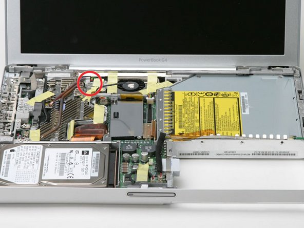

Add Note Edit Step 30  ¶
  • Disconnect the Bluetooth cable and deroute it.

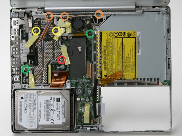

Image #1
Add Note Edit Step 31  ¶
  • Peeling up yellow tape as necessary, remove the following 8 screws:
    • One 4.5 mm Phillips on the right side of the heat sink.
    • Three 6 mm Phillips near the display.
    • Two large 7.5 mm Phillips with springs (don't forget to remove the springs). If the springs are not releasing, needle nose pliers can help get this done.
    • Two 13 mm screws from the left side of the heat sink and the right side of the fan.

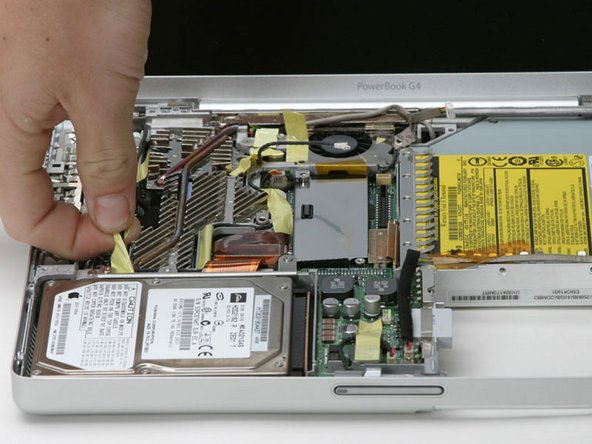

Image #1
Add Note Edit Step 32  ¶
  • Remove the yellow tape to free the cable from the left side of the heat sink.
