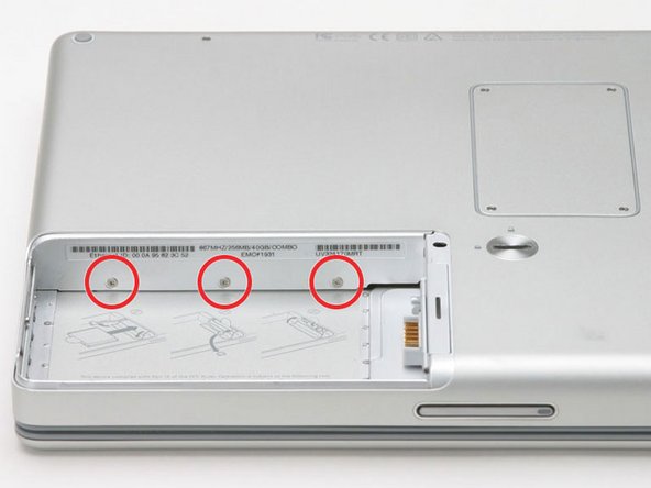

Add Note Edit Step 12 — Upper Case  ¶
  • Remove the three small Phillips screws from within the battery compartment.

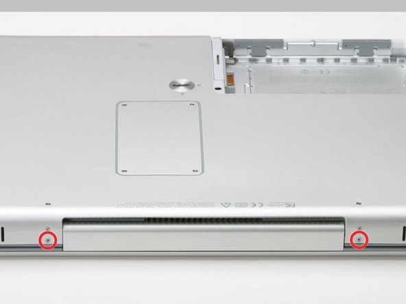

Add Note Edit Step 13  ¶
  • Turn the computer 90 degrees clockwise and remove the two medium-length Phillips screws from the casing.

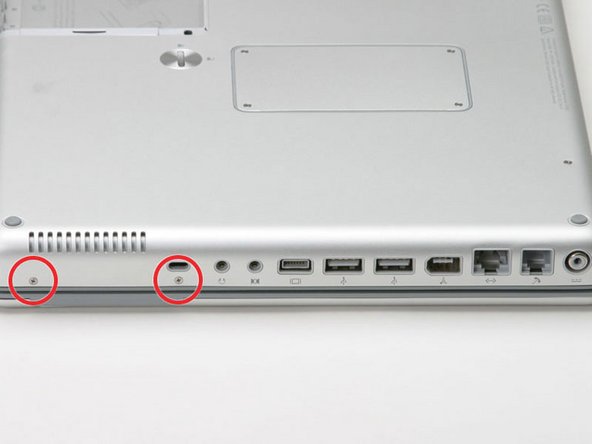

Add Note Edit Step 14  ¶
  • Turn the computer 90 degrees clockwise again, and remove only the bottom screw on either side of the hinge.

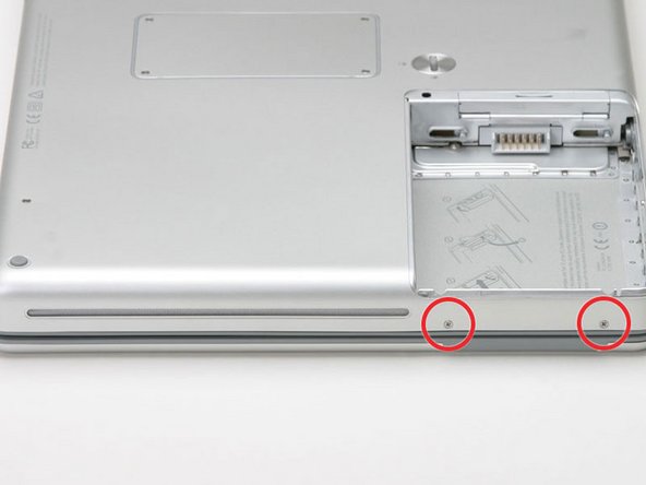

Add Note Edit Step 15  ¶
  • Turn the computer 90 degrees clockwise just one more time, and remove the two Phillips screws on the exterior wall of the battery compartment.
  • Remember these two screws are longer and have shoulders.

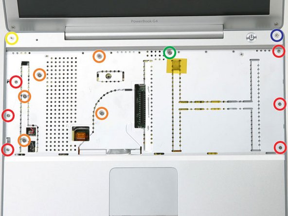

Add Note Edit Step 16  ¶
  • Turn the computer over and open it up.
  • Remove the following 14 screws:
    • Six 2.5 mm Phillips on either side of the keyboard area.
    • Five 4.5 mm Phillips on the left half of the keyboard area.
    • One 7 mm hex in the upper left corner of the upper case (a T6 Torx driver will do the job nicely).
    • One 15 mm Phillips in the upper middle of the keyboard area.
    • One 16.5 mm hex in the upper right of the upper case (again, a T6 Torx driver will work well).
