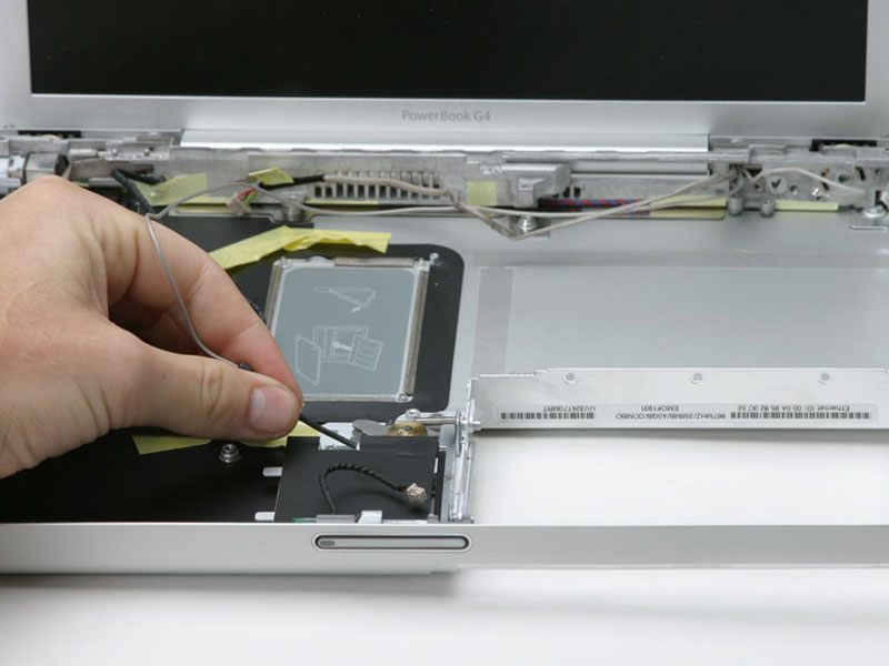

Add Note Edit Step 4 — Airport Extreme Card  ¶
  • Flip down the door on the right side of the battery compartment.
first image
Add Note Edit Step 5  ¶
  • Use a spudger to disconnect the Airport antenna from the card.
first image
Add Note Edit Step 6  ¶
  • Grasp the plastic tab and pull the card out all the way.

Add Note Edit Step 60 — Display  ¶
  • Deroute the Airport Extreme antenna from the card slot and lower case, removing tape as necessary.
