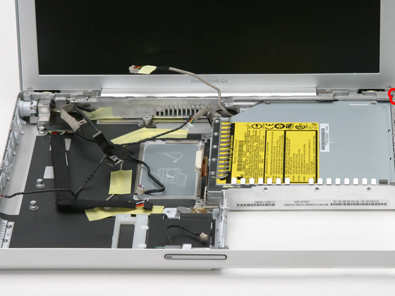

Add Note Edit Step 51 — Optical Drive  ¶
  • Remove the two Phillips screws from the upper right corner of the computer.
  • Remove the newly-liberated small metal bracket.
Image #1
Add Note Edit Step 52  ¶
  • Remove the two recessed Phillips screws on the right side of the optical drive.
Image #1
Add Note Edit Step 53  ¶
  • Lift the optical drive up by its front left corner and pull it out of the computer.
  • If you have a CD or any other object jammed in your optical drive, we have an optical drive repair guide.
