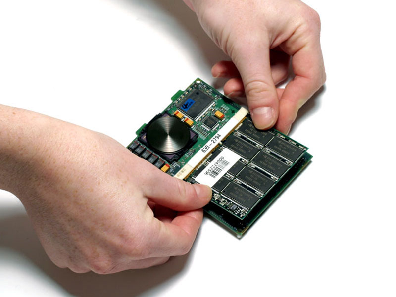

Two RAM slots allow up to 512 MB of PC100 RAM.
Image #1
Add Note Edit Step 1 — Keyboard  ¶
  • Remove both expansion bay modules using the levers on the front of the computer.
  • Insert your index fingers inside the expansion bays and search for the two ribbed tabs on the underside of the upper case. The tabs are located near the bottom corners of the keyboard.
  • Pull the tabs toward yourself and the keyboard will pop up.
Image #1
Add Note Edit Step 2  ¶
  • Pull the keyboard forward to disengage the tabs holding it in back and rotate it toward you.
  • Rest the keyboard on the trackpad.
Image #1
Add Note Edit Step 3  ¶
  • This is a diagram of the ribbon clamp connectors you will disconnect in the next step.
  • 1) With your fingernails, grasp the locking bar on either side and pull up a small amount (about 1/16" or 2 mm).
  • 2) After disengaging the locking bar, slide the cable out of the connector.
Image #1
Add Note Edit Step 4  ¶
  • Disconnect the two keyboard connectors by disengaging the clamps and pulling the ribbons directly upward.
Image #1
Add Note Edit Step 5  ¶
  • Slide a spudger downward between each plastic strain relief cable and the wall of the case in order to bow out the cable beyond the small tab holding it in place.
  • Once the strain relief cables are free, lift the keyboard off.
Image #1
Add Note Edit Step 6  ¶
  • Your laptop should look approximately like this.
Image #1
Add Note Edit Step 7 — Heat Shield  ¶
  • Remove the two Phillips screws from the heat shield.
  • One screw is shorter than the other. When putting the Wallstreet back together, this screw goes in the middle of the heat shield.
Image #1
Add Note Edit Step 8  ¶
  • Grasp the metal handle on the heat shield and pull up and toward yourself.
